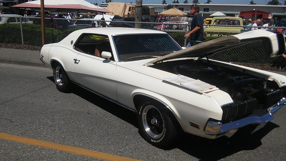

Both 69 and 70 L/H mirrors have the C9WB- part number. In 1969 Mercury did not offer a R/H Racing mirror for the Cougar. So no C9WB- part to be found. The information I gave earlier is for what was used for the 1970 Cougar. And what I used works well.
This mirror mounts jut out side of the the XR-7 Stainless window trim in the concave area. The L/H mirror has a flat space on the top of the door but the passengers side does not. I find the mirror to be more decorative than functional. It always vibrates out of aliment and is small. But can be helpful.
