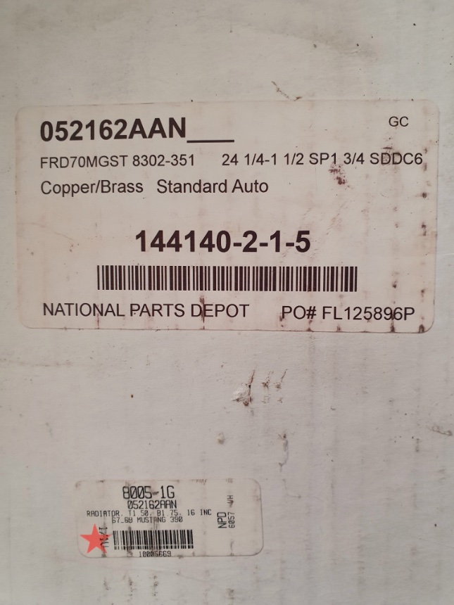

The link you gave says it is a 16 inch wide radiator. The photo shows a 24" wide 1968 - 70 radiator .A 1967 390 used a unique 23" wide radiator originally, clamp in style. So there are issues here.

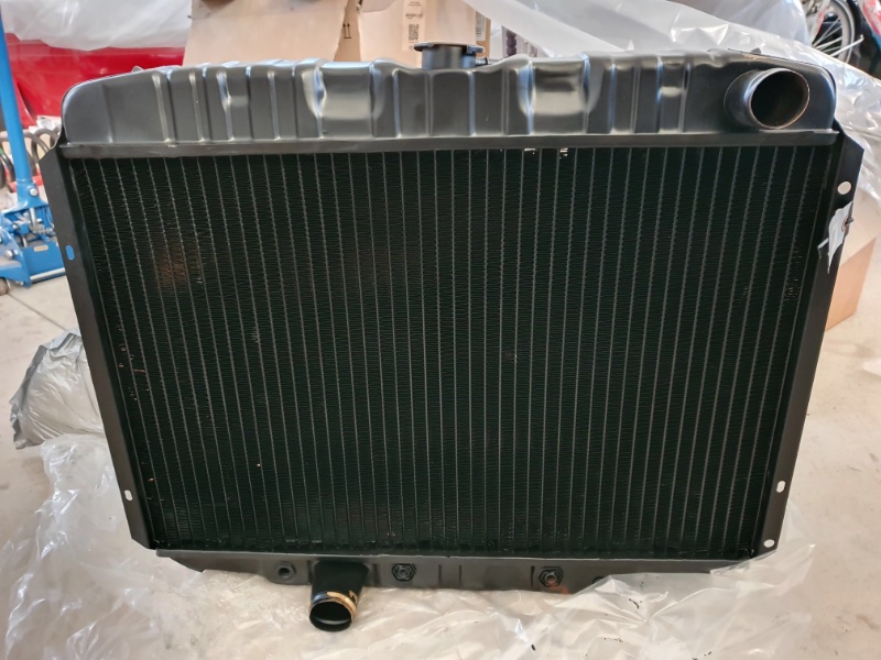

I guess they mixed something up at NPD. In the description it’s 16x24“. So I think it’s 24“ wide. I attached some pictures I got from the seller.
That radiator is for 1970 302 or 351 with clamp in 24" radiator. It won’t work in a '67 390.
You can convert to a 24" 1968 - 70 390 / 428 radiator if you purchase the 1968 lower brackets. Your '67 came with a one year only 23" wide radiator. The lower brackets are for 1967 only. To use the 1968 - 70 lower brackets you will need to drill and tap holes in the frame.

I agree with Royce on this radiator. Looks like a 1970 351 radiator that will not fit a 1967 with a 390. There is a difference in the lower mounts from a 67 to 68. I already made the mistake of thinking te 67 and 68 390 radiators were the same. Don list the 67 390 radiator core on the WCCC web site as a 22 inch radiator.
