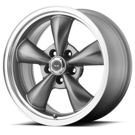

Well I finally pulled the trigger on some new tires and wheels for my cat. I picked up some of those Sumitomo’ Mustang Unlim had for cheap. The HTR A/S P02 225/50V16.
And with Cyber Monday I bought Brand: American RacingStyle: AR105 Torq Thrust M
Bolt Pattern: 5x114.3 (5x4.5")
Offset: +35mmBackspacing: 5.38"(136.65mm)
So since all these numbers are new to me I am hoping to get some affirmative feedback on sizes and had a question on the back spacing number.
I ran these through a tire calculator and found that my new wheel back space is 12mms (.47")more than what the calculator shows it should be(124mm). My question is am I in trouble then with space on these? Or will there be some options to make them work? Hope that makes sense.

This is a pretty specific issue. It would really take some one with the exact set up you have to give you good information. I hope that happens but it is probably unlikely. The good news is that it sounds like a 12mm spacer can fix the problem if there is one.

Tire selection for 16" is still limited. 17" is more popular and puts the tire above the upper ball joint. 4.5 back spacing works with a 17" rim. I don’t know about 16" and most likely will depend on how wide of a tire you’re going to run.
So looks like you are definitely right on a 16" wheel not clearing the upper control arms. So if I drop down to the 15" inch up front will the 7" wheel width clear OK?
I had ordered a 225/50/16 so tire width would be 8.9" for the 225mm. Any insight on that too.
I’m hoping I can use the 16" wheels on the back and just get the 1 5" for the front.
The back spacing is still a question because these are 5.45" as noted above.
Are there options on changing the control arms to some that might work better?

I do not think that you will find much of a difference between 68 and 69. I know that the spindles are the same and I am pretty sure that the upper and lower control arms are as well. I do not believe that the jack stand location would make much difference. If you have the stands under the frame then the suspension is dropped down as far as it will go. If you have the stands under the lower control arm then the suspension will be up as far as it goes. Either way if the wheel hits the upper control arm now then you would still have a problem if you were driving the car and needed full suspension travel.

Randy, thanks for your input. I am thinking at this point to return what I purchased and start over. I underestimated the many nuances in wheel fitment.
I think since I am trying to stay as close to stock on my 68 XR7, a 15" wheel seems the more likely choice with the correct back spacing to avoid any issues.
