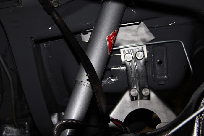

Does the rear brake line route between the muffler hanger and rear seat well or on the outside of the muffler hanger before connecting at the flex line bracket? Seems like it can go either way but I cannot find a photo showing the correct installation because the axle is always blocking the view. This is for a 1969 XR7 M Code. I have everything loosely connected for now with the brake line outside of the muffler hanger. See attached photo.

Dave, I get the order on installation but is the hard brake line positioned in front of the muffler hanger (between hanger and axle housing or behind muffler hanger (between hanger and body pan). The new brake lines and fuel lines do not seem to exactly lay where they ought to.

Dave, thank you. That was what I needed to know!
I think it’s right in your first photo.
Royce is correct.
I found a photo from the Waco Eliminator that shows it outside to the rear of the muffler hanger.
I will keep it where it is then. Thank you for the photos - it is very helpful.
