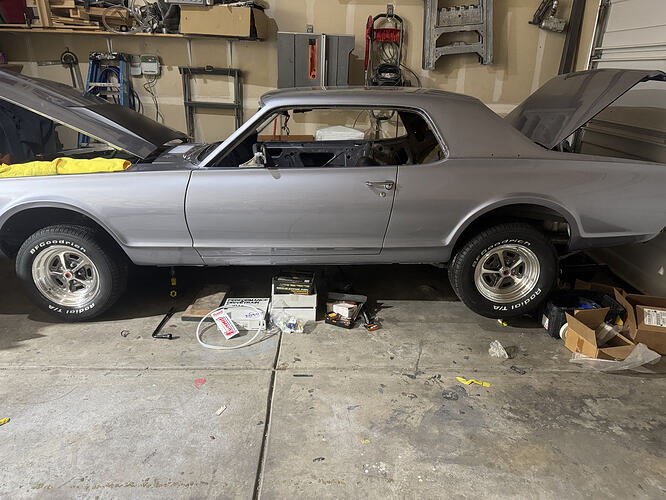

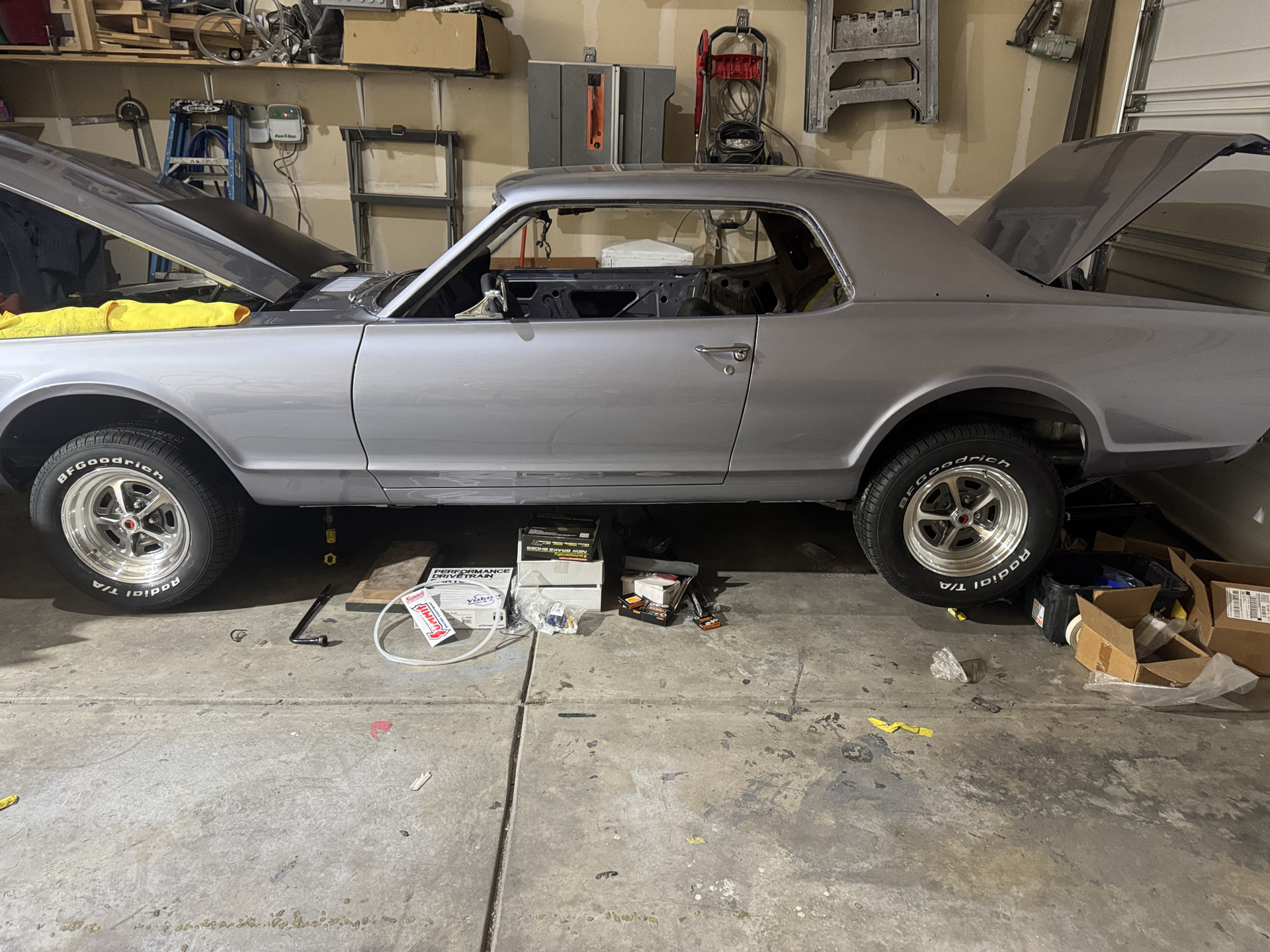

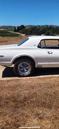

Got a question about the rear end leaf springs. I noticed in some post online and my cougar’s wheels are about 7/8 of an inch forward of the center. Does anyone know why or what we can do to get the rear end pushed back 7/8 of an inch? Here are a couple pictures on found with cougars having the same issue.

I can tell in your picture that the car is not on the ground. Are the jack stands under the rear axle or the body? If under the body move them to under the axle. That will give you an idea of how the axle will sit on the ground.
