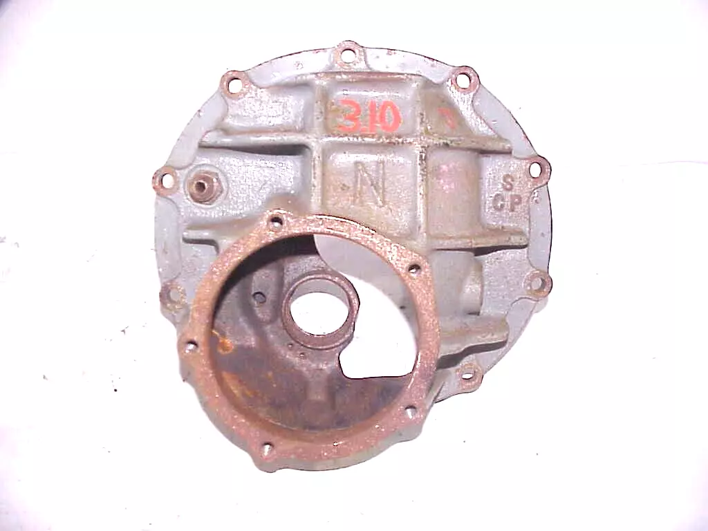

It’s not a nodular case. No “N” on the case. Would be nice though
Some early N cases do not have the N on the outside. But do have the extra rib. See picture for rib location.
Yes this is a case with the N.
The big N on the outside of the case did not appear until mid 1969 model year. So all earlier cases did not have the large N in the casting. The cast number is C4AW - so the C7 case is not likely the right one but the low performance 28 spline “single rib” version. Still it is easily worth $350 for the case and the Locker unit.

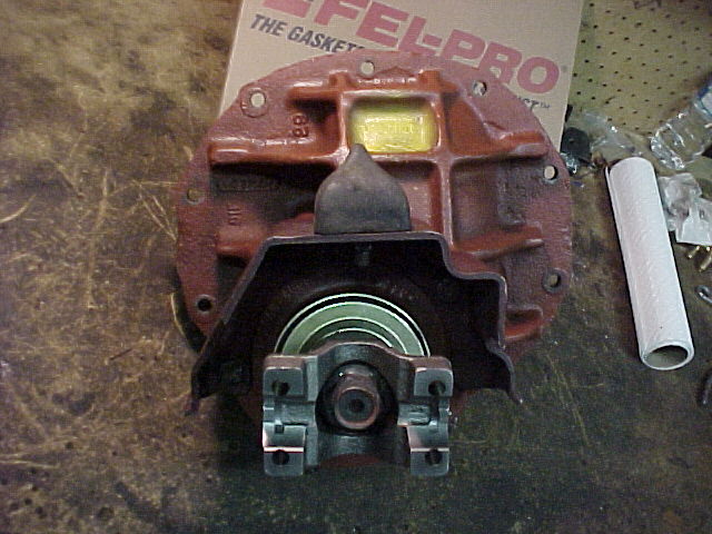

Here’s a case with the C4AW and no N for reference.
