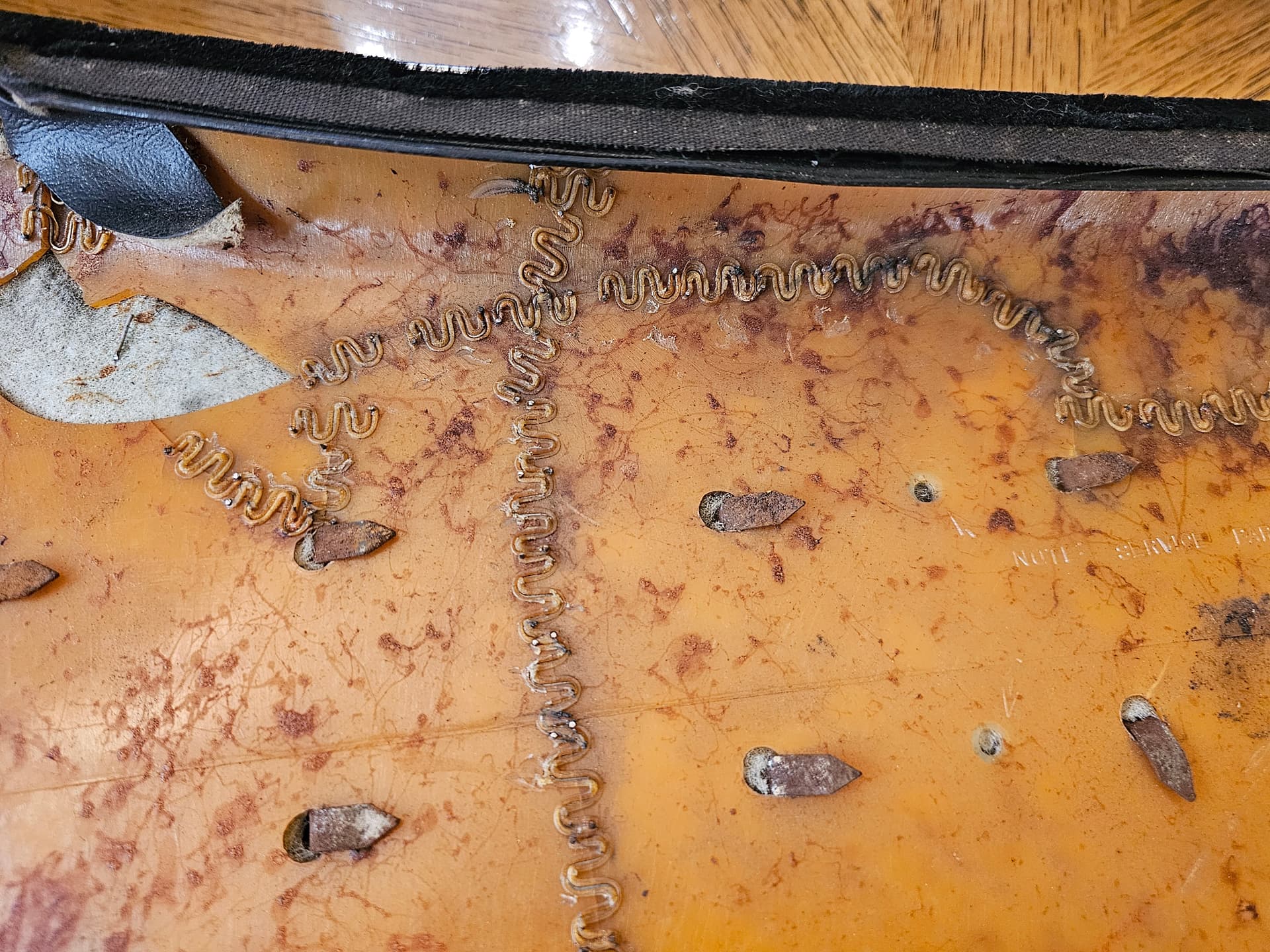

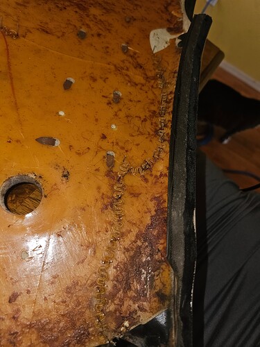

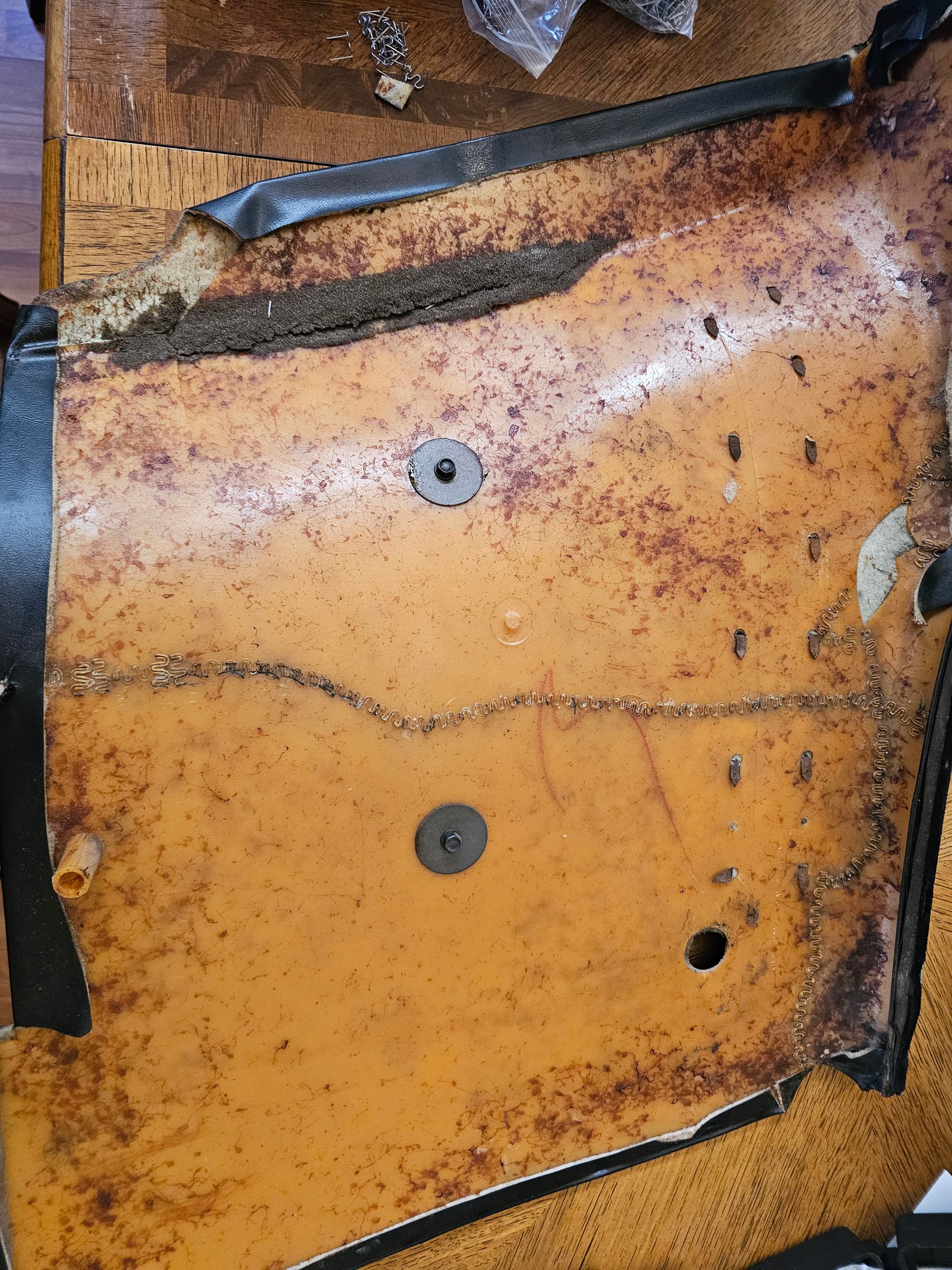

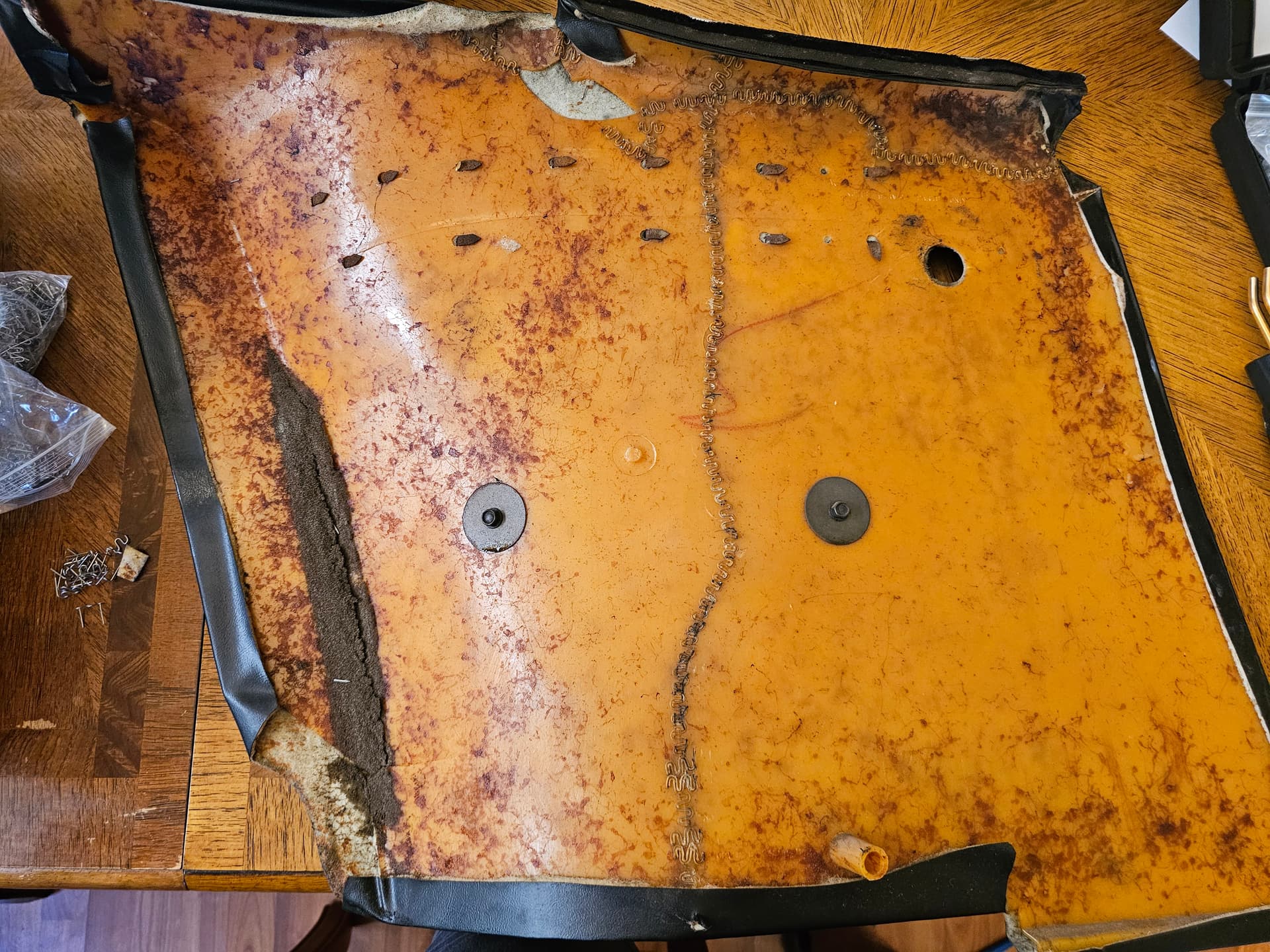

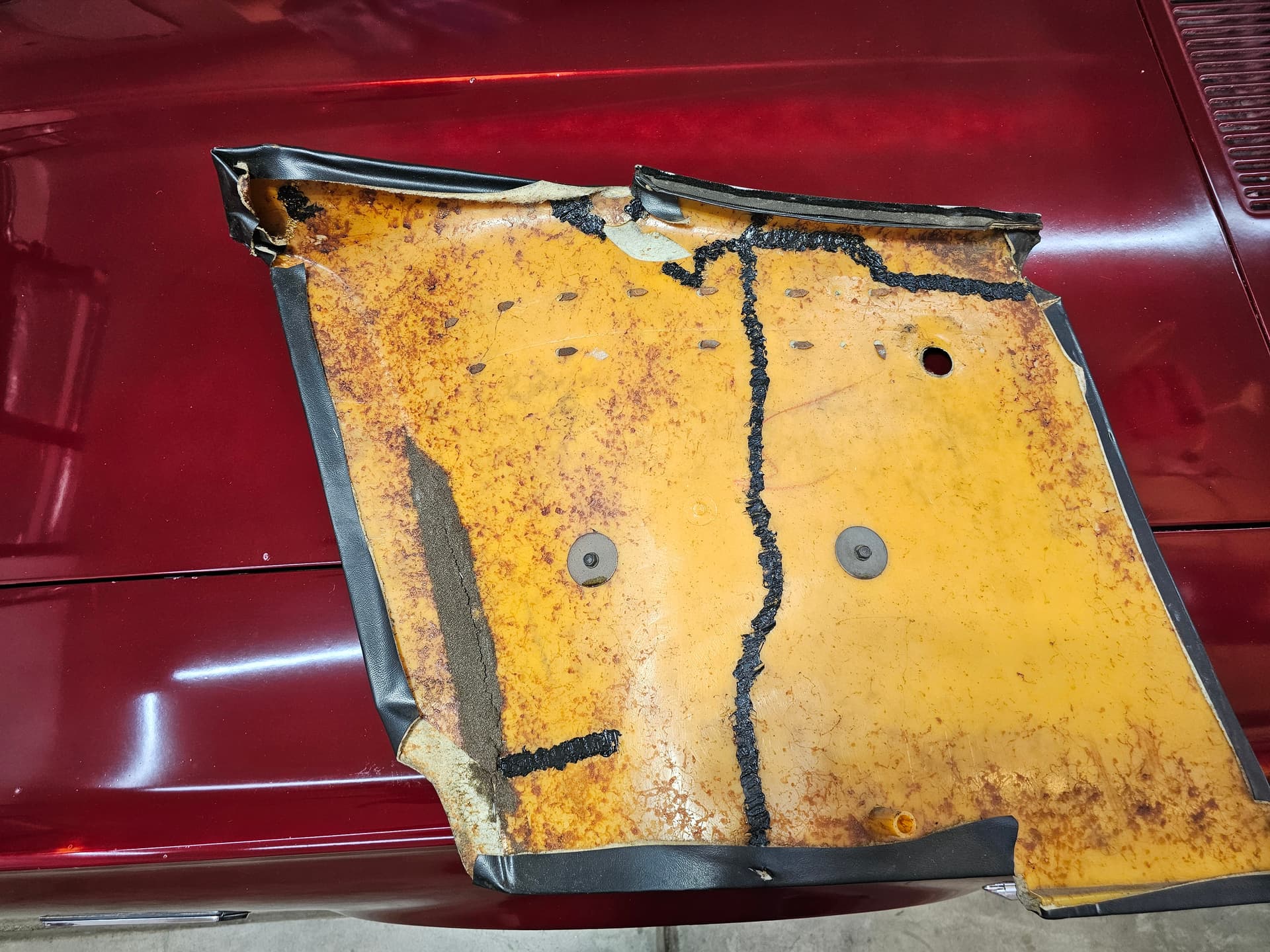

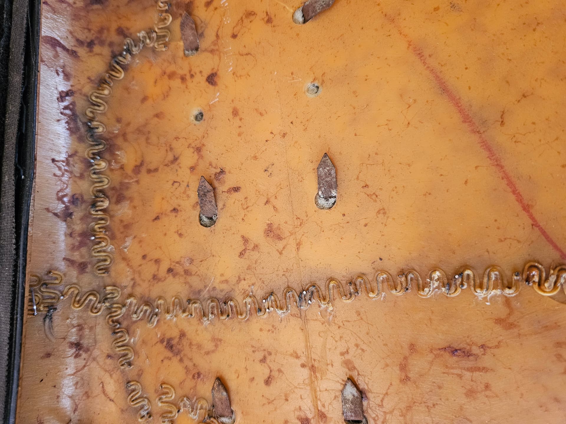

Hi, this is a repair I did for my 68. I looked for an answer to this awhile ago but didn’t find anything, so when I found this tool I was pretty excited. It’s a plastic welder, cheap on Amazon. Uses little metal clips that hold the plastic together when melted in. Don’t think it’ll make these hold up any better to people putting weight on it when getting out of the back seat, but it’s now super solid for normal use.
Looks like it works. Aren’t the panels (back part only) being reproduced?

I used a roll of fiberglass tape and some liquid JB plastic weld worked out real well
