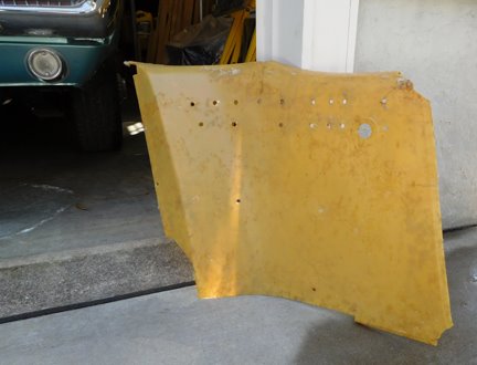

Help! I’m trying to repair the Rear Interior Panels before sending them to the upholstery shop and the usual solutions (fiberglass resin, JB Weld) aren’t working. What are they made of?

I’ve repaired some using fiberglass Mat cut to size and using 3M emblem adhesive to saturate the glass.
I have been dealing with the same problem on the passenger side on my 67. Had a guy use fiberglass made it to thick to use. If you go that route keep it on the thin side.

I would try this. I use it to repair all kinds of boat stuff.
http://www.fawcettboat.com/pc_product_detail.asp?key=841DF8D9B5D44A1D87DE95DFBB93DCC4&_vsrefdom=adwords&gclid=Cj0KCQjwzIzWBRDnARIsAAkc8hGVLSlJndVpxvXjlom2IlSv-Y6g6aaYREEIXIjbXrYZVDpFN7spf6IaAjDeEALw_wcB
It doesn’t stick instantly, so you will need to clamp the broken pieces together for a few hours until it sets.
It also works great for filling holes. You just put masking tape under the hole, then mix that stuff up and slather it into the hole. It’s sandable and paintable once it sets.
I had several cracks in mine and I used fiberglass wallboard joint tape to cover the splits/cracks on the backside and then used Locktite 2 part fast curing epoxy glue covering all the tape. What I like about using the epoxy is it settles and sets smoothly over the repaired area. That was 7 years ago and they are still fine.

I recently used a two part glue made by Locktite. It had a preactivator, and then the glue. It was on the plastic defuser on my AC blower behind the console. Wasn’t getting anything to stick to that plastic either (JB weld, plastic epoxy) The plastic broke out around the metal tab on the underside. It held using the Locktite.
I used 1-2 layers of fiberglass with epoxy resin. Bought at a surfboard manufacturing supply shop. Just make sure you really scuff the panels or it wont stick well. Very difficult to do without cracking more when the car has been sitting in the desert for decades.

If these panels are made out of ABS plastic like the dash bezels are, you can make an ABS slurry/paste by mixing pieces of ABS plastic with Acetone. The acetone with melt down the ABS plastic into a paste. Spread a little inside the seam before putting the pieces together then reinforce it a little over the top of the seam on each side. I repaired my cracked dash bezel this way and it makes a strong bond once the acetone evaporates from the paste and hardens back into a plastic. Several youtube videos on making ABS cement. I have a few pieces of that panel at home i can test it on to see how it works.
Thanks for all the suggestions! I was experimenting with fiberglass cloth and clear Gorilla glue. That worked if the surface was scuffed or sanded before application. The West Marine Plastic Boat Repair Kit looks interesting, I’m going to try that on the other panel.
