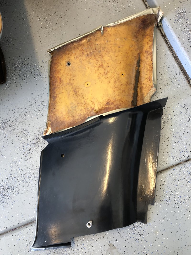

Not sure of the quality of the reproduction ones, but the originals are super fragile. I haven’t seen any good ones (no cracks) in years. Especially here in Arizona where the heat kills them all…

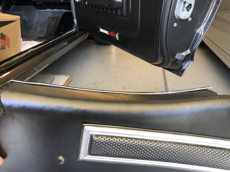

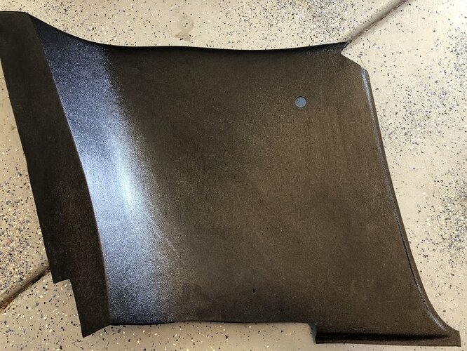

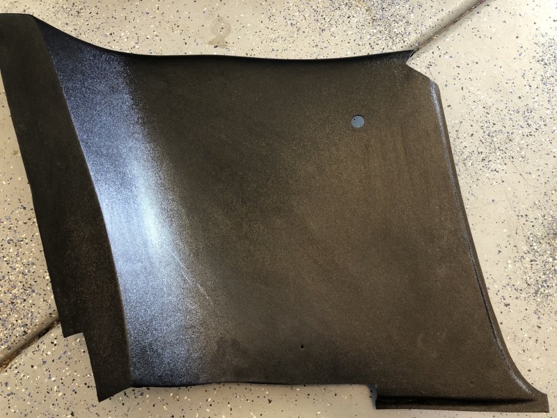

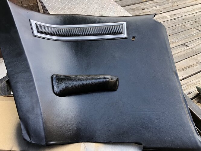

quality is good on the repros but you do have to trim to fit. The material is a bit thinner and more flexible which made it somewhat of a challenge to get the vinyl swapped over and not distort the panel. You also need to add any holes from the arm rest and decor trim. Also the area of the window seals are contoured slightly differently so the seal doesnt sit all that great. However with that said they are a great alternative to trying to find a non busted up original. Overall happy with them then trying to source a good pair of originals.
repro bare
felt trim fitment
repro with decor vinyl swapped over
I do not know how my back panels held up after shipping them to SMS. But what I did with my broken panels that fixed them.
Super glued all the cracks and right after sprinkled baking soda on the glue. Chemical reaction bonded the panels they were good and solid when I shipped them. Will see when & if I get them back how they held up. This was on my 70 Convt so the panels are harder to come by.
