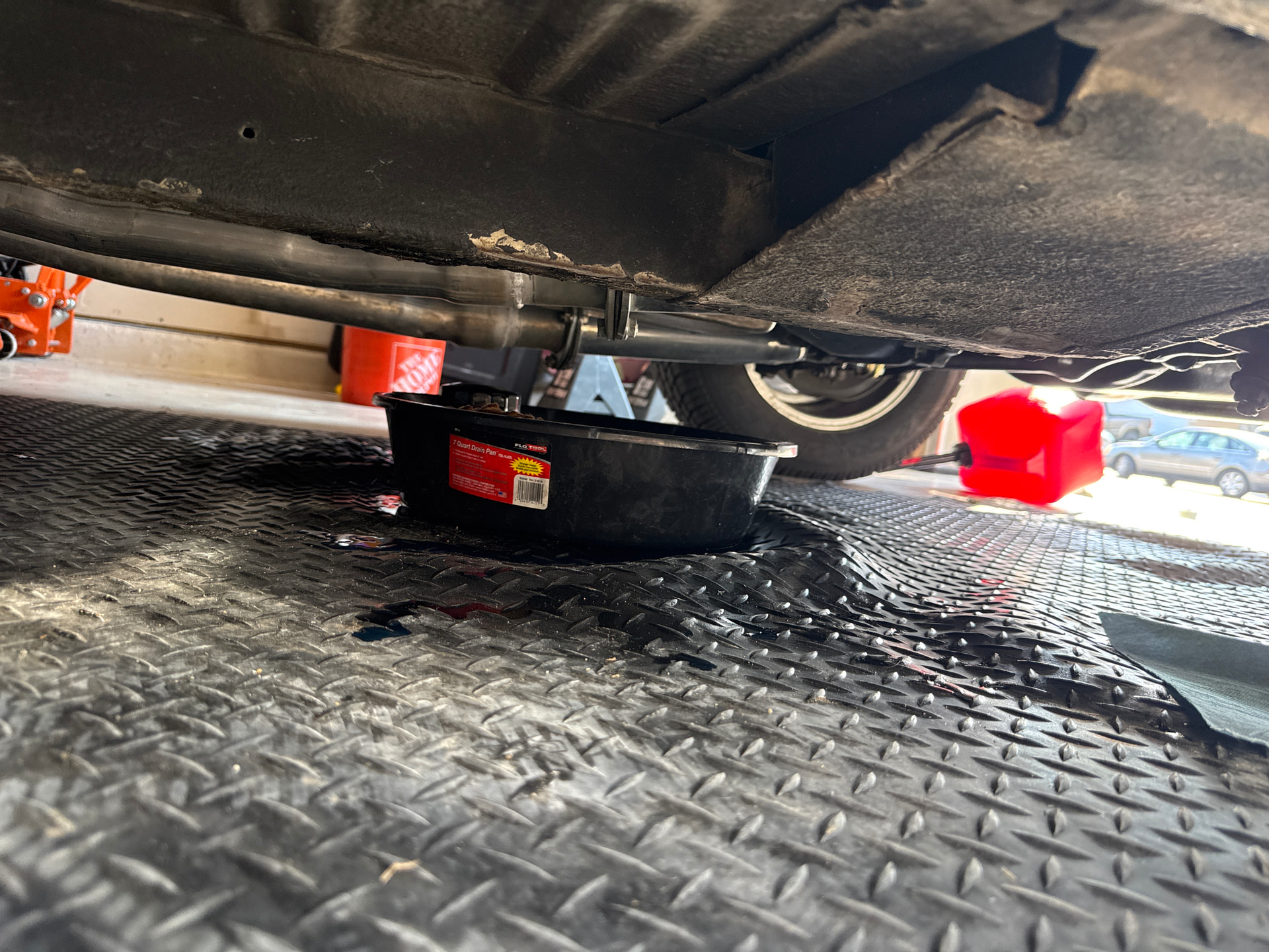

Recently took my car to a shop to have the c4 rebuilt. Get the car back and it shifts AWESOME. Two days later I notice an oil puddle appearing under the transmission that was never there before. I start looking around and can’t find anything near my first though (valve cover). At this point, I’m beginning to think it’s a bad rear main as it only happened after putting the transmission back together. I’ve watched videos and read forums on how to do the process with everything still connected. My question is, do ya’ll think there’s any way it’s leaking from somewhere else?? The leaking doesn’t seem to be coming from anywhere on the top and it drips out a lot whether I drive the car and it thins out or it sits for a couple weeks in the garage. Really wanting to finally drive my car again. TIA.

It’s the factory 302 and c4. Mileage unknown. I’m leaning towards RMS simply because it only happened once popped apart. When the car was on the lift and trans was out, I stopped by and saw no leaks. Car only leaked after I drove it the 45min home the day I picked it up. Now, I’ve cleaned three huge puddles up from under it and can’t find anywhere obvious it’s leaking. Currently leaking.

I was thinking it had to be seal as it happened when I drove and it parked. Once I noticed the puddle keeps happening whether I drive or not, I started rethinking my diagnosis. I don’t want to have to pay labor to take it apart and replace it as I can’t blame the shop for it going bad at their fault. I got everything I’ve seen recommended for the job (sneaky Pete, etc.) but, want to see what others thought about possibilities before I cause a new problem.
IMO you should determine where the leak is coming from before you pull it apart. If it leaks when running then get it on a lift. I wouldn’t be afraid to see if the tranny rebuild shop would help take a look at it. Valve covers can leak a bunch of oil too. Hard to see from your pic where it might be coming from.
After a 2nd look at your pic- if your drip pan is where the leak is then it’s a transmission leak. Could be shift lever seal leak as those leak pretty good on a C4. That seal is on drivers side.
It’s not possible for that to be leaking engine oil is it? I can’t see how any leaks from the trans could have any oil but, I’m also not very familiar with the inter-workings of the transmission. I’ve checked valve covers and I’m certain it’s not coming from them because there’s no oil coming from the sides of the block and I cleaned the surface with degreaser rag and checked periodically to find no oil on my white paper towel from them.
A leaking rear main seal is going to show up at the rear of the engine where transmission bell housing bolts up. Below where starter bolts up and the leak will drip out bottom of bell housing. Your drip pan looks to be midway under the transmission well behind the rear main seal. Your drip pan looks to be under the transmission oil pan. Get the car in the air see where leak is. Who knows maybe tranny shop goofed up and put 10W30 in the tranny? You just had transmission work done- check that first. Rear main seals usually start with a drip then progress slowly.

Yeah. Levels are pretty low. The majority of the fluid/oil has been periodically wiped up and thrown away on rags.
Depending on how bad the transmission shop is, I’ve seen transmisssion bellhousing and corners of the engine block being broken off, which if cracked in a non optimal spot could lead to an oil leak…although not terribly likely, worth thinking about. Also, if it’s an original engine and the belllhousing area and oil pan area were caked with old oil leaks and dust (which hides leak). Now after they cleaned that area the already present oil leak is more prominent because there is nothing for the oil to “soak” into since they cleaned it up, you might have exposed what was already a leaky RMS
From the position of the oil drip pan, it’s definitely under the transmission. As others have pointed out you need to get under it and see where it is coming from. I’ve seen a few where the new shifter seal or o-ring has leaked.
