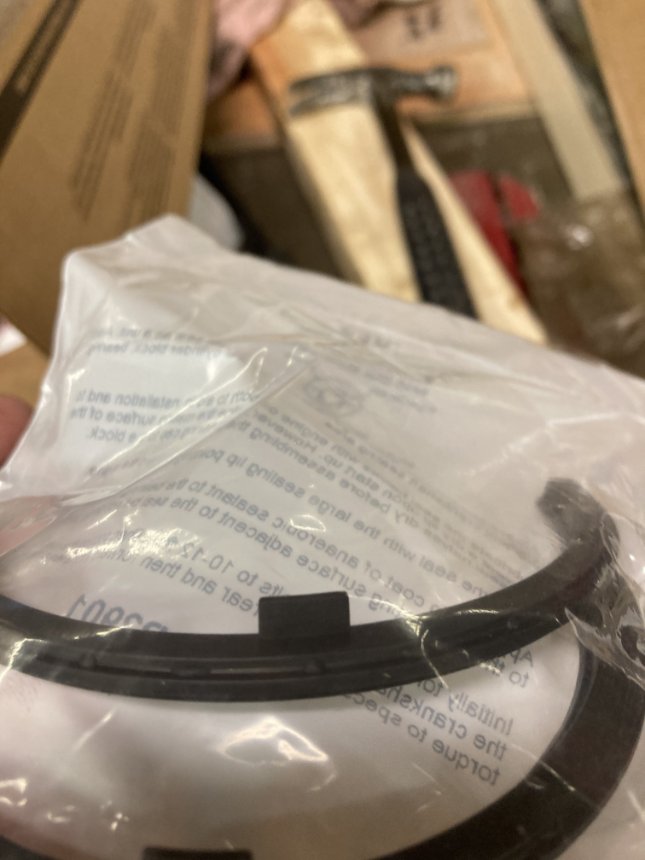

  2. Bought fel pro performance seal. There is a tab on the seal (see attached pic) This is fel pro part number 2901 and for 68-80 302s. Old one doesn’t have this. Any issues with that seal? I don’t see how that will slid up on the top with that tab on there?

Oh and cut those tabs off
