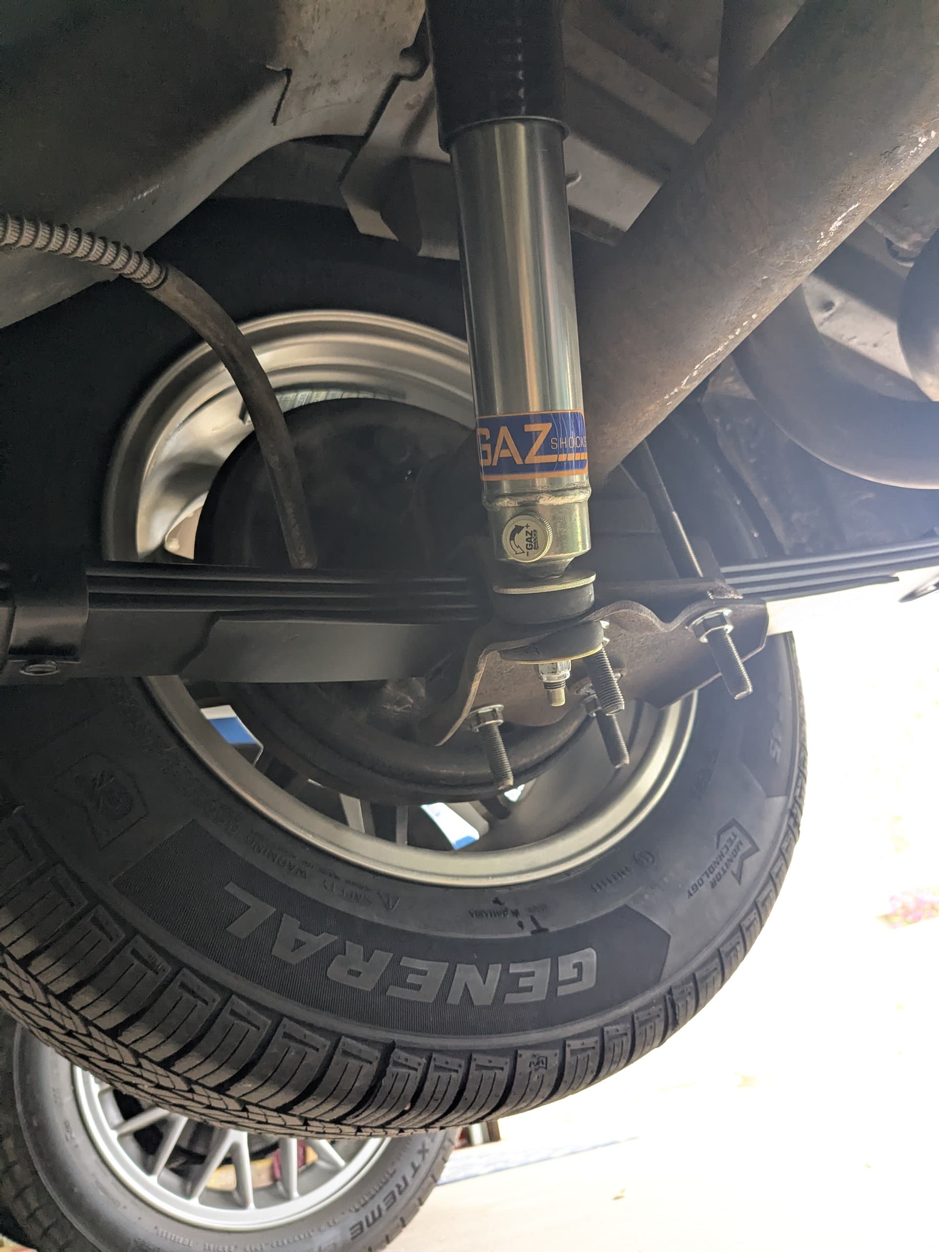

I took the rear shock length from the WCC site and studied shock specs from various shock companies and discovered that the rear shocks on a Triumph TR7 or 8 match for compressed and extended length. I found a British parts company, Rimmer Bros that sell shocks for Triumphs. I ordered a set of adjustable GAZ shocks p/n GSA3741GAZ. They are fairly priced even with the tax and shipping. Delivery was less only a couple days. I’ve had them on for a month and have had no issues. I have the adjustment at mid range. As a bonus, there is an external knob for adjustment, removal not necessary to adjust.
