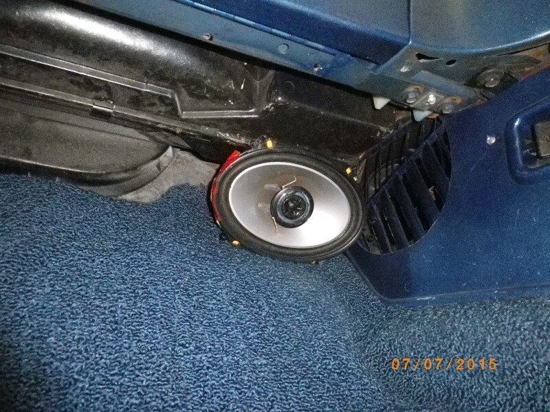

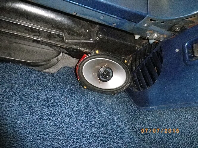

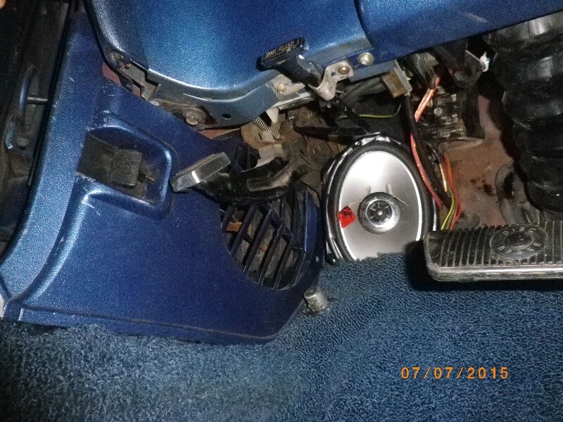

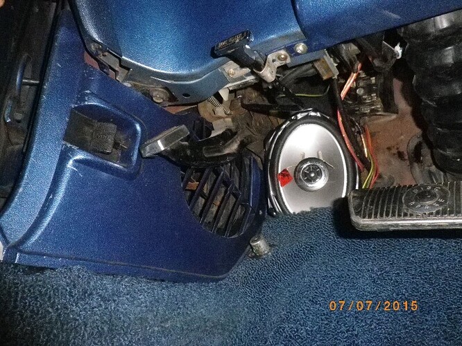

If 4"x6" (±5½x7½ with frame) is larger than what you mean by “little tiny under-dash speakers”, then see how it’s done in mine:
They are easy to remove to go back to stock look and far enough in the front not to be disturbing (my wife and I are 5’6").
I would wish to add 2 more in the back, but like you can’t figure how to fit them without making irreversible modifications.
