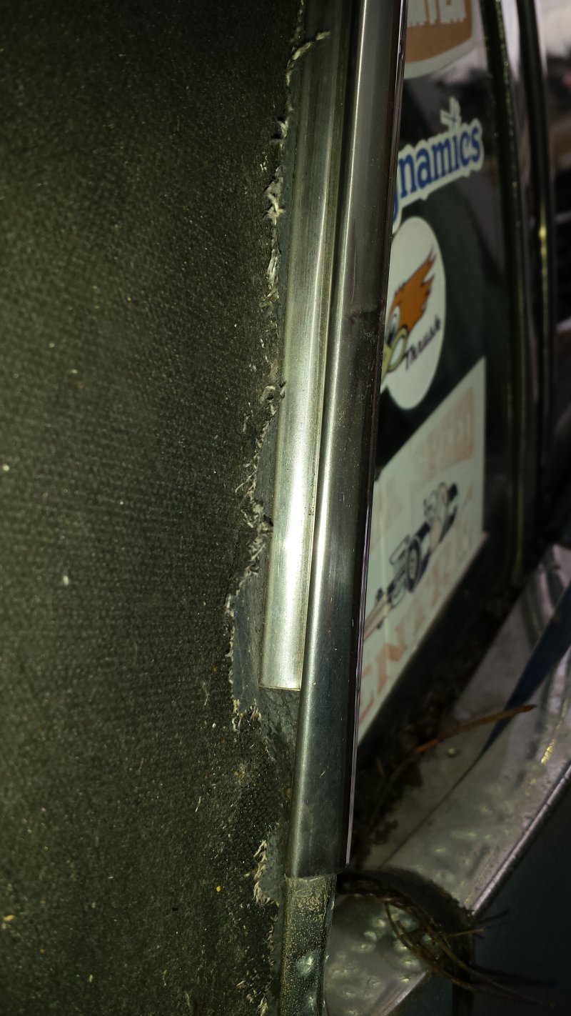

I read on another thread just recently (that I can’t seem to find now) that there are also SS trim pieces along the Drip rails that are easily destroyed if removed wrong. My restored G doesn’t have these and I’ve never seen them on a restored Cougar. Started tearing into the dis-assembly of my parts car and it still has these along with the metal trim pieces along the bottom as mentioned above.
What is the correct way to remove them??
Small std screw driver, carefully start lifting
Thanks Don. I’ll post another pic after its off.

My understanding is that this piece of trim was installed by the factory and almost always thrown out when the roof was replaced. They are easily damaged. Don has a listing for them under 68 roof parts but they show as out of stock.
