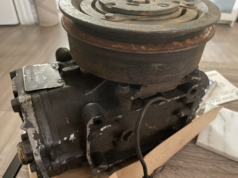

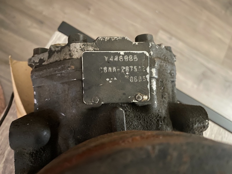

When I purchased my cougar, the AC comp was in the trunk. I believe it is a York compressor.
Would anyone know the model number or if they sell rebuild kits for this compressor?

it’s a York or Tecumseh compressor. Most vendors carry rebuild kits or new ones. https://www.npdlink.com/1967-1973-cougar/heating-cooling/air-conditioning-components/compressor-parts-accessories?year=1968
They’re heavy and use lots of hp to run and need to convert to 134a which makes them less efficient unless the condenser is changed as well. if you don’t care about keeping original. Install a Sanderson compressor and condenser which makes the switch to 134a.

I’d like to keep it original if possible, weighing in the cost of both options. This won’t be a daily driver so I’m not concerned about HP loss when it’s on.
When making the change to r134, does anything else be swapped out besides the condenser?
The valves to the compressor need changed to 134a. Different oil in the compressor. Need a new dryer install. You can use the old condenser but not going to cool as well (3 circuit vs new 6 circuit). 134a isn’t as efficient as r12.

I also have been considering reusing my old compressor and have discovered that it is possible to buy rebuild kits for both the Tecumseh and York models. Based upon what I have read the Tecumseh units are cast iron and the York is aluminum. My Tecumseh compressor has HG1000 stamped on the tag. As far as I can tell they are interchangeable. I am replacing a bad heater core and will change out the AC evaporator to the new style with more tubes in case I change to 134a later. Original Auto Air and Max-AC.com are good places to start for parts. Does anyone know how to test the old hoses to see if they leak?
