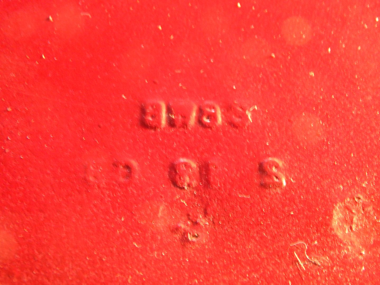

I pulled back the right front fender to uncover the VIN per Jim’s request. I was confident from the bottom that it was the same as the dash and the door. They are. The left front fender also matches the other VIN’s. I chose not to disturb this fender because it is obvious that it is correct. I use a magnifying mirror to read them from the bottom.
I removed the rear seats and all the sheetmetal date codes in the rear area match the date codes on the front pieces. Most are late February and some earlier. The car was built on 15 March.
Below is the VIN number photo. I will post some of the rear sheetmetal date codes. This car was originally red as the Marti report states.

Over all of seat area. The car was originally red. The front date sheetmetal date codes I sampled all predate the 15 March build date of this car. I did not take pics because they are visible without disturbing anything.
Right cross brace January 20 1968
Left cross brace January 20 1968
Panel forward of gas tank side to side. February 18 1968
Panel on left rear quarter that taillight panel spot welds to. February 9 1968
Panel that top of left side cross brace spots to.
