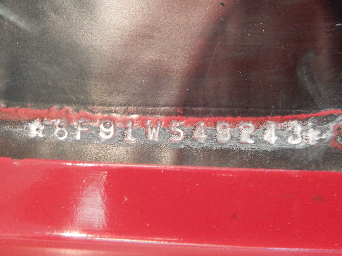

@Rob I would like to see a wider view of fender apron VIN, plus images of underside of fender apron VIN.

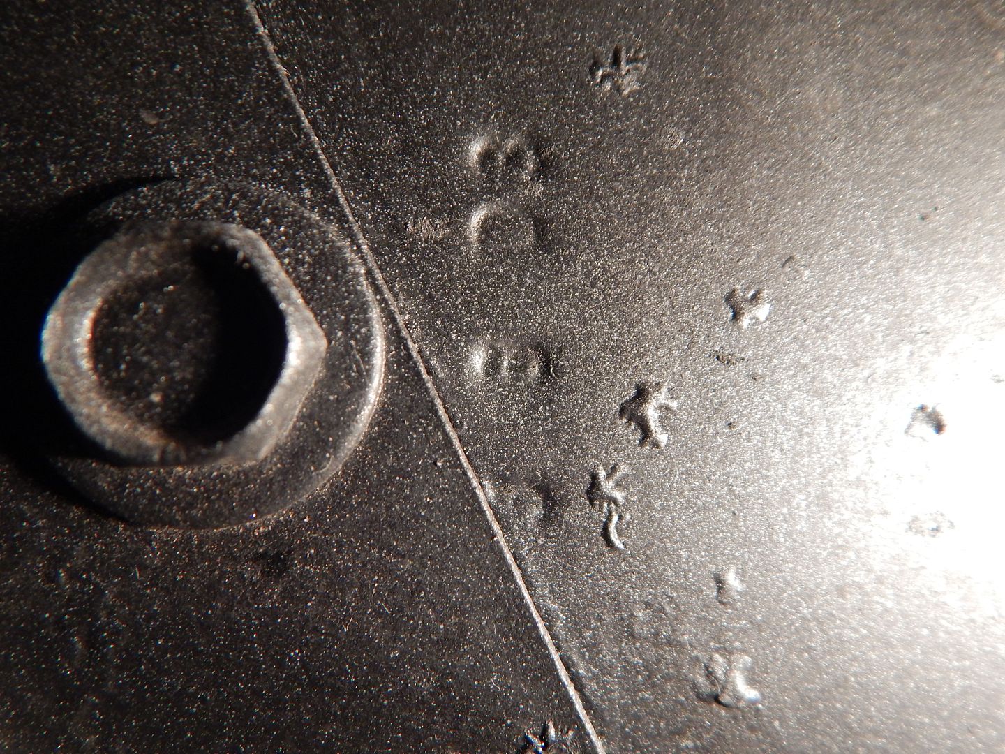

Here are the final photos of this GTE. I have sheetmetal date code photos of both the battery apron and the left from inner apron that have the VIN numbers as well as the left side VIN number. Enjoy. I took a “wider shot” so we can see the cars engine compartment. I thought about taking a photo of me taking the photo… Remember this is not my car I am just a local Mustang restorer who has been into Ford since 1971.

A bit closer to the drive side VIN
The driver side VIN
Driver side inner apron the VIN is in. February 21 1968. A bit blury but the 2 is clear for the month.
Driver side VIN from bottom.
Driver side coil spring cover February 29 1968
Passenger side VIN from bottom
Passenger side date code in battery apron. March 8 1968 still ahead of the 15 March 1968 build date of this car.
Passenger side coil spring cover. Same as driver side February 29 1968.

Battery apron is March 8 1968 not March 6. I have corrected it in the previous post. I will take a nice shot of the taillights soon.
