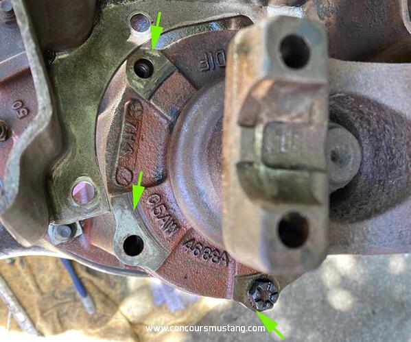

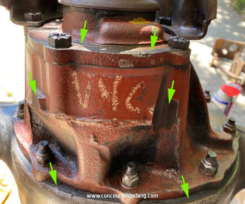

Also if want a more original looking final product since your already there, don’t forget the fresh machined spots on the main case and pinion retainer for the full factory look while your at it. Face of the housing where the gasket attaches was left unpainted also

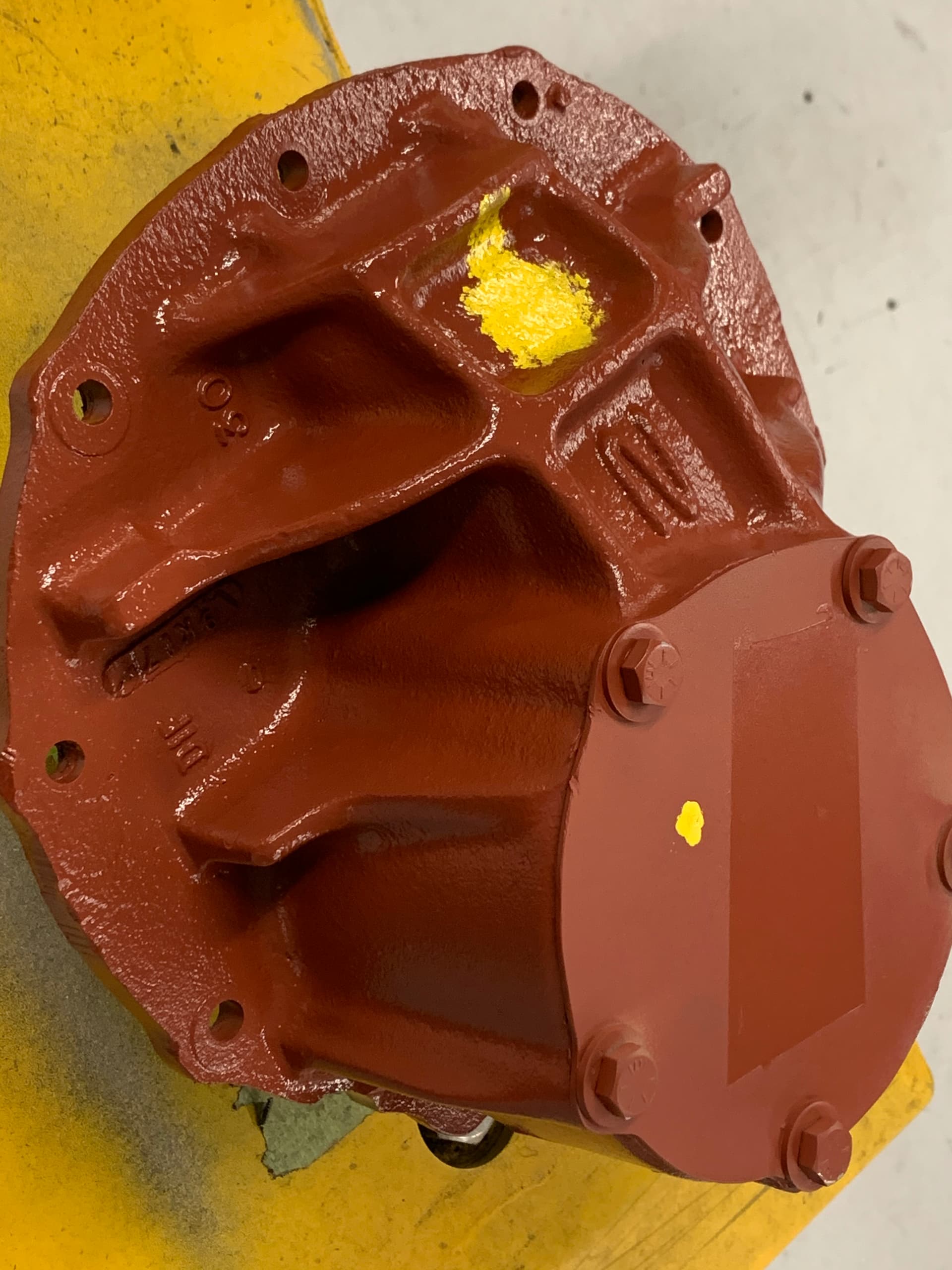

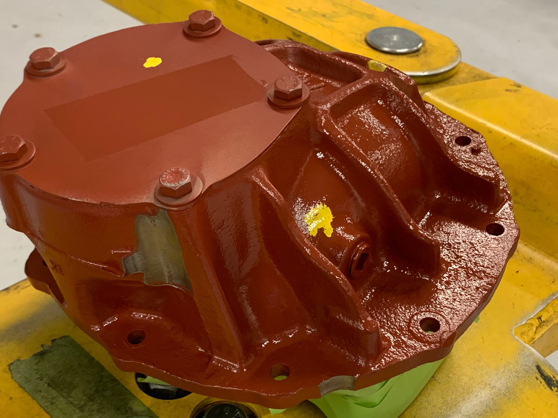

Here’s the color I used, I think it was Krylon and then a 1k clear coat to get the sheen.
