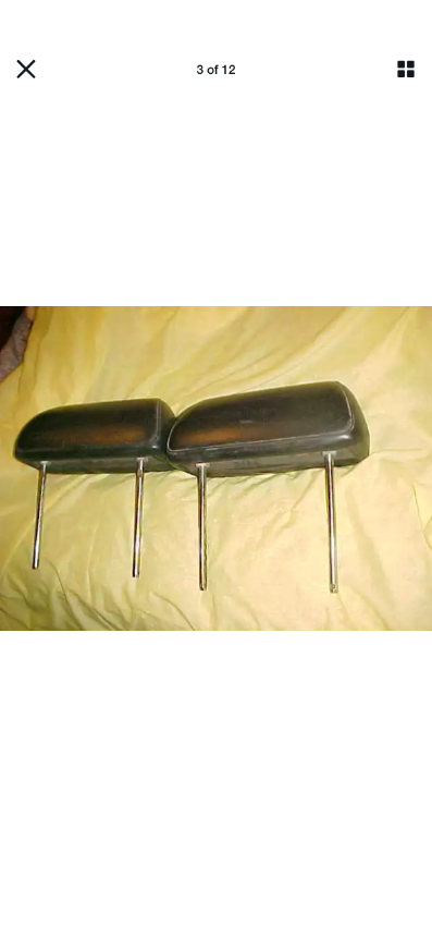

Before you get too excited pull your headrests up and see how they are supported. Are there 2 round tubes? Or 1 flat bar? 1968 headrests are very hard to find. 1969 headrests are very easy to find as every car received them.

Hmmmm… so, do we have a rarity with the single bar head rests in the 68’ or, are we run of the mill… keep in mind this isn’t the original interior!
Those are ‘69 seat frames in your ‘68. I have the same in mine.
Looking at your photo it appears that none of the interior panels is correct for the car. With the car being a GT-E it is valuable enough that you can probably justify buying a '68 standard Cougar to use as a donor for a correct / good condition saddle interior.
The 1968 headrests are tough but the good thing about them is that the headrest brackets can be bolted to any standard 1968 Cougar seat frame. Also the headrests are not XR-7 specific - all are the same other than color. They can be dyed or recovered successfully. The same headrests could be optioned in a 1968 Mustang - even rarer than Cougar.

Also how much should I expect to pay for the headrests? I found a set of black ones for $350 and that seems high to me
Make sure you also get the (4) mounting brackets, and the (4) chrome plastic escutcheons. That’s a good price if they are complete.
Just the headrests no hardware, but they are the correct ones I believe
I’d pass on this. You’ll spend another $350 for the rest of the parts, and it’ll take another 6 months to find them.
