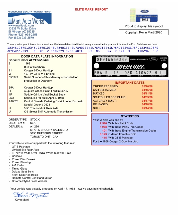

Hi everyone! So here’s my W code Marti report. At some point in my cars life it was rough and someone who didn’t know any better found a really nice restored car and swapped in the grills and interior, not knowing the original stuff was specific to the car. The Marti report shows that it had saddle crinkle vinyl interior, deluxe seat belts, console, and head rests. Could anyone weigh in with pictures of their 68 base model cougar with that interior so I know what I need to be looking for? It would be highly appreciated

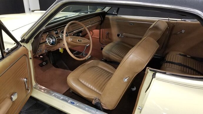

1F interior

Hey guys, thank you for the 1F post. I do have the gte book, but couldn’t totally tell the difference in photos. Do you know what makes the interior “crinkle” vs not? I found a 68 302 2v xr7 that is Augusta green and saddle interior I want parts from. I know certain things are xr7 specific, but kick panels and what not should be the same

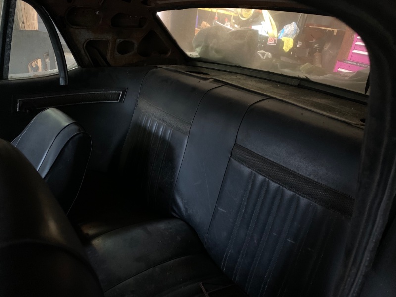

The black interior that is currently in my car is deluxe then because it has the matching strip from door panel to seat surround
If the basketweave panel on the rear seat side panel has a half circle cutout to go around the window crank it is a 1967 standard style panel. If the basketweave stops before it gets to the window crank then it is a 1968 deluxe style panel. The front seats look to be 1970 or newer high back seats.
The front seats are near mint 69 mach 1 seats that my father set in the car because the original low backs were in terrible shape. I do still have the originals, they are the match set to the black rear seat, but need covers and foam repair
69 Mach I front seats use the same frames as 69 Eliminator. Those are a 1 year only seat and not easy to find.
