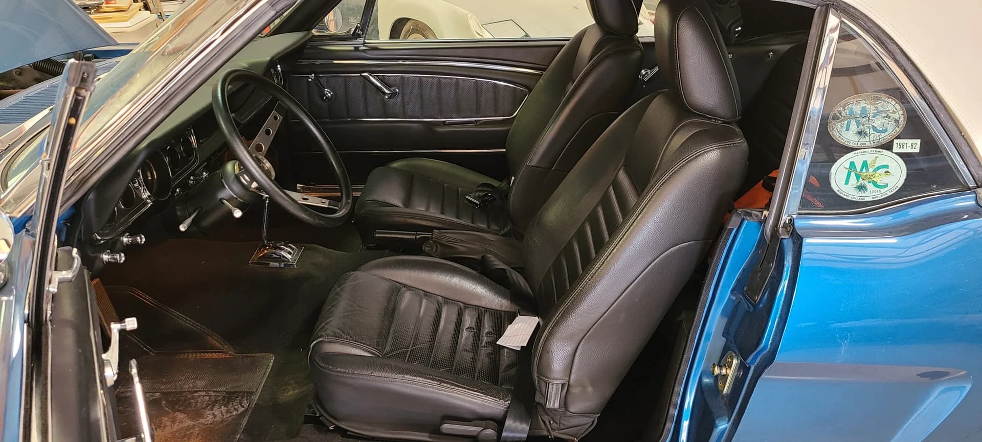

We chose honda prelude seats and had them stitched up as Cougar seats. Alot of new technology in seats sincs 1968.
As to seat alternatives here is a good article ( and place to start ) looking at ‘options’:
https://www.vintage-mustang.com/threads/other-ford-seats-in-mustang.1194931/
Personally if I weren’t doing a concours restoration, I’d choose to replace the '69 XR-7 ( White leather ) buckets with a fox body ( late 70’s through mid 80’s ) set of white leather Recaro buckets. They had similar pleating / stitching and looked like a good fit. The Vintage Mustang forum article shows a number of those Fox body style of buckets in Mustangs. This image is 2008 Mustang seats in a 1966 Coupe. They really don’t look out of place.
