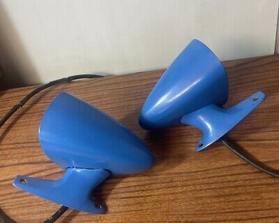

this is the ad I saw, and it just didn’t seem right to me-
That set of mirrors is for a Mustang. They will not work well on a 70 Cougar. They are intended to mount to the side of the door, not on the ledge at the top of it.
