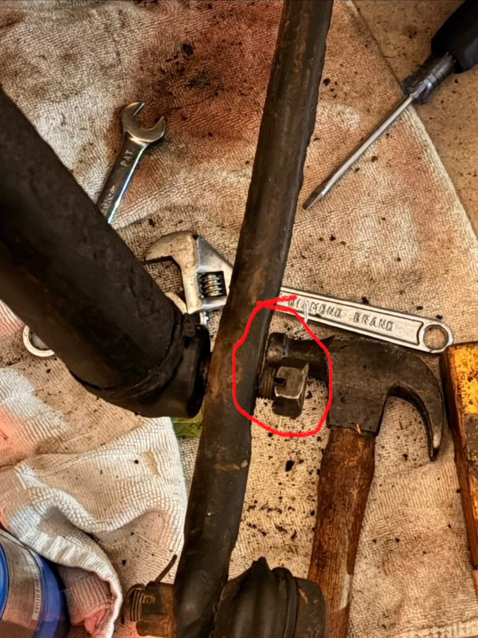

Any one have any suggestions for how the remove a stuck power steering power cylinder at the castle nut/bolt? I have been working all afternoon to get it off (BFH, heat, liquid wrench)and nothing. I am trying to save to bolt so I can rebuild the cylinder see and not have the cost of replacing it.

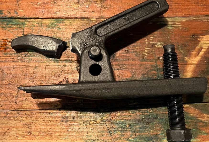

So true PopsOtto. Nasty break there

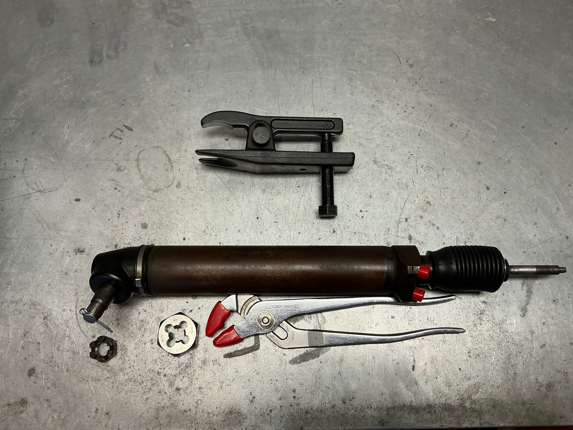

So I used the tie rod separator to pull my power steering ram cylinder, but still managed to deform the tapered stud enough that the castle nut won’t go back on. Think I can save it by chasing the threads with a 9/16 x 18 die.
Also, there is maybe 1/32” between the brass scraper and the snap ring after I got the new seals in. Just enough that the seals move in and out slightly when the piston changes from extension to retraction. Does that sound right?
Well, my Saturday morning project has consumed the whole weekend, but am happy to report success! After grinding off 1/16” of the mangled tapered stud, I was able to grip the taper with rubber jawed water pump pliers and clean up the damaged threads with a 9/16” x 18 die. I think if I had used the back side of the castle nut to protect the end of the tapered stud from the tie rod puller, I probably would have been OK.

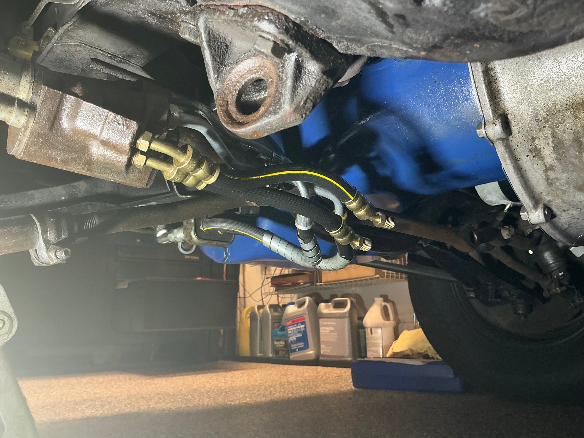

And of course I’m not done yet - my 10 year old Blue Dot shorty hoses to the power cylinder were weather cracked. Better replace them - again.
I went ahead and got those exact same hose on yours and others recommendations. I hope mine last 10 years + also.
Those are great hoses that fit right, and don’t leak a drop. They probably would have gone another 5 yrs. But I had one burst once and drove back home with manual steering. What I didn’t realize at the time was that the power steering pump damages itself when run dry. And you can’t cut the power steering pump belt off without losing the water pump. So I’m extra careful now about the condition of the hoses.
