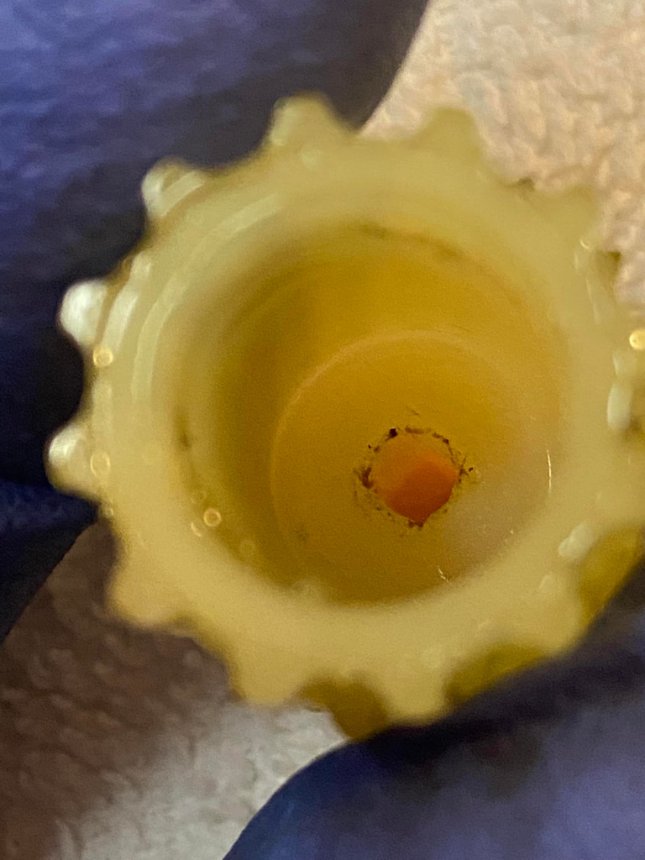

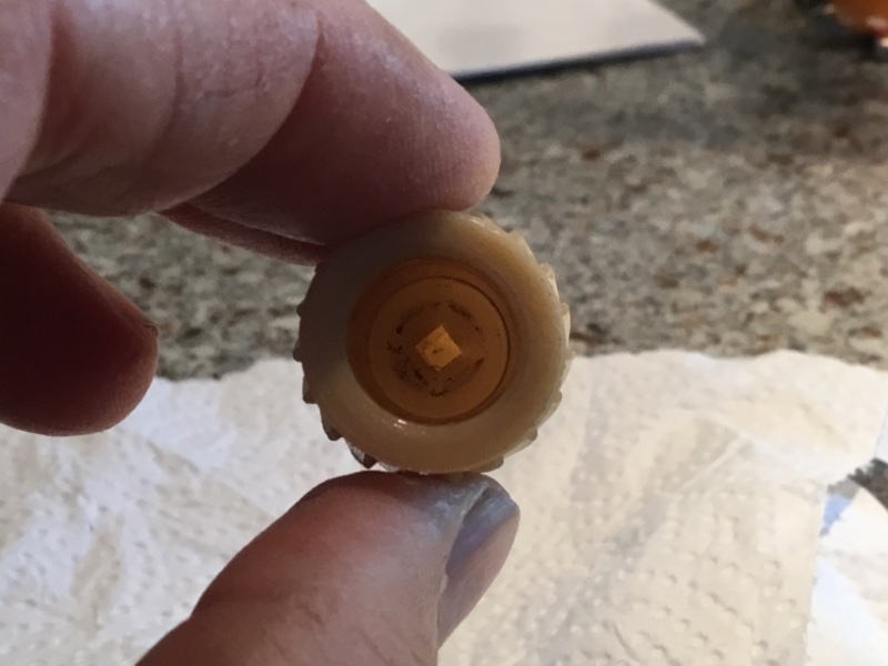

Did you check the condition of the plastic driven gear for the cable inside of the transmission ?
The driven gear appeared to be in good shape
Take a good look at the INSIDE of the driven gear. If the cable puts too much tension on the nylon gears the nylon can give and strip out the inside of the gear. When that happens it can cause the gear to “skip” on the cable and give you a bounce.
Either way, the gears are only a few bucks and are easy to replace.
Thx. I’ll try that next. Gotta pull the gear to count the teeth so I get the correct gear.
Sounds like an “apple cored” gear.

I pulled the driven gear, hoping to find it was apple cored but it looks really good. Still, I will replace it and see if that helps.
