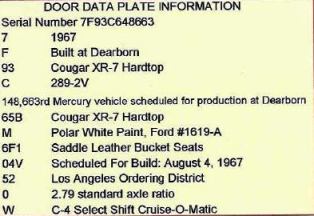

Really, they only put saddle brown in saddle interior cars? I didn’t know that. Mine always had a black pad. Would that explain the 6F1 coding?
This is where there’s a little confusion. Off the cuff I want to say that XR-7’s had black, and Standards had brown, but can’t say for sure.
The trim code won’t tell you anything more than the level of interior (Standard, Decor, XR-7) and the color. So C7XR7’s example 6F is XR-7 Saddle. I’m not sure about the 1, I’ve never seen a 3 digit trim code before.
The only type of trim code that calls out the color of the components (carpet, dash pad, etc) is for white upholstery. My car has an AA code, which is Standard Parchment with Black appointments (but strangely the seatbelts were a tan color, so I’m replacing them with black).
Marti (the guy not the report) said that 6F1 meant there was some anomaly in the interior. For example, if they ran out of a certain color part they may have used something else - like subbing a black dash pad in place of a saddle dash pad. Problem is it doesn’t designate what it was that was different.
Well, ya learn something every day. That’s interesting! Must be pretty rare.

If it helps I have a fairly early 1967 XR7 (Ordered 4/27/67) with saddle interior and the original dash pad was black.
