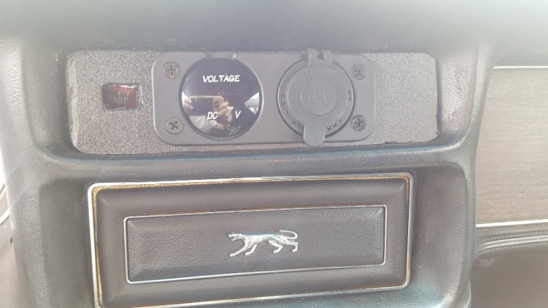

A cigarette charger in the center dash where the brake light warming used to be along with a few dollar volt meter I got off EBay.

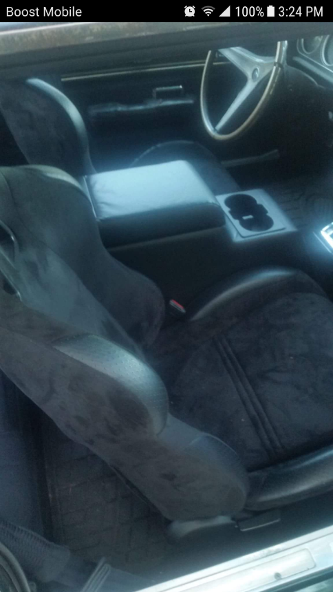

Two Chinese type racing seats that recline. Bonus they saved 52 lbs from the car.

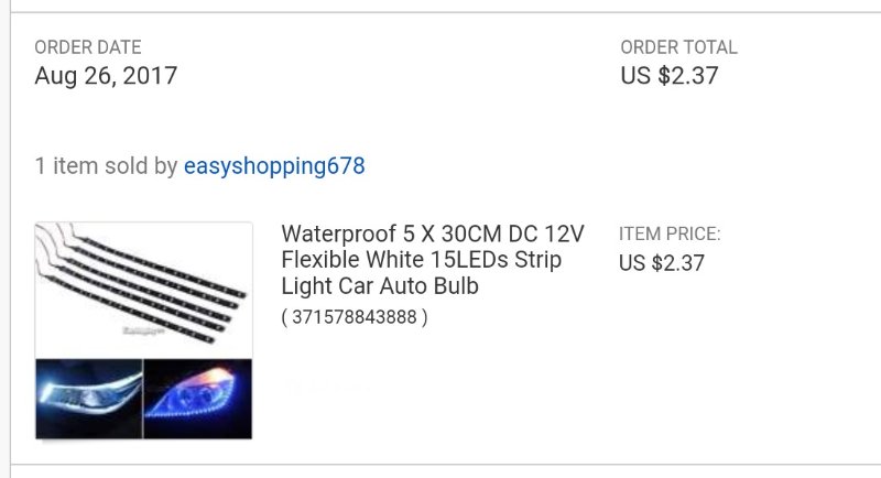

Wired in an led light switch into the trunk with Led lights

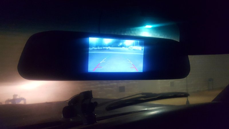

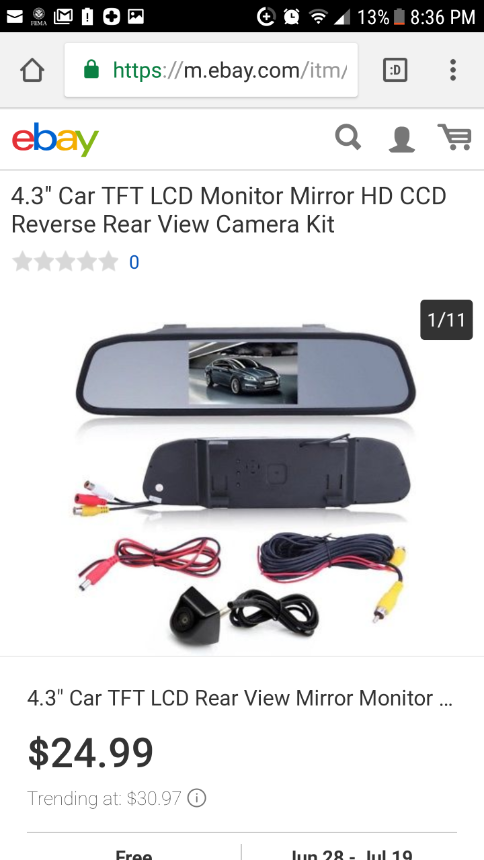

I’m stuck working some crazy overtime for the month so my posts will be limited till then. On the backup camera
this is basically the kit you are looking for. I won’t place links as they will expire in a few months with eBay. Search eBay backup rearview mirror kit. I’ll write up a how to later on tonight in another thread and link it here. Avoid the wireless versions, I’ve read reviews of the monitors picking up feedback/static while driving at random times. Something you won’t get with the wired versions and you want everything to only go on in reverse.

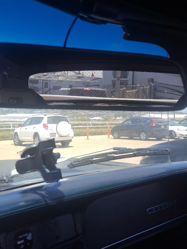

Here is how it looks during day or when driving.
Here it what I see when I back up (nighttime used a camera much more vivid but it is still very viewable during the day.)
One of the biggest benefits of this has been parking on the street late at night during the winter. Not having a rear view defroster my back window will be fogged up. I can drive fine as car headlights still show up fine through a fogged window. When I’m parking though, yikes! Except, I’ve discovered the camera isn’t affected so I just use my monitor to park.

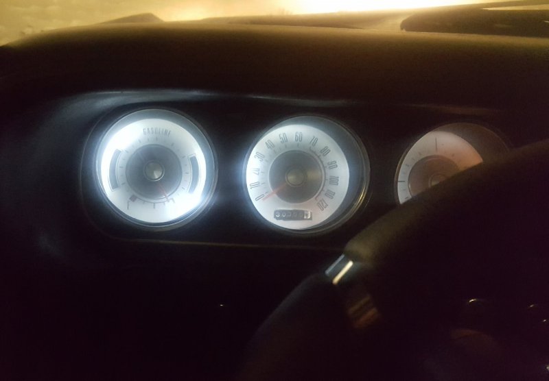

White faced gauges with white LED lights.
The original dash lights were so dim, they drove me nuts. So this is what I have now with by upgrading the faces to white faces and white LED dash lights.
I tried green led dash lights first. The color hurt my eyes. The white looks much better to me.
The dash lights are 194 lights
They look like this.
The faces covers come from here For $20.00
http://www.whitegauges.net They sell a brushed silver version that I’m curious what it looks like for $30 bucks more.
The dash lights were kinda finicky. They were on and later not from time to time. I replaced the light switch which fixed this issue.

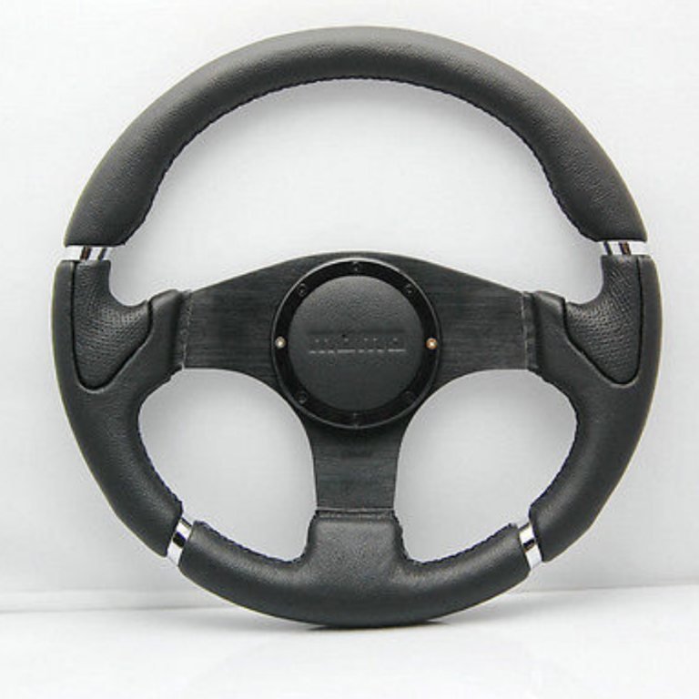

Steering wheel I replaced mine with.
( I won’t give you exact.link on eBay but they are currently about $55)
I’ll post a picture of it in my car soon.

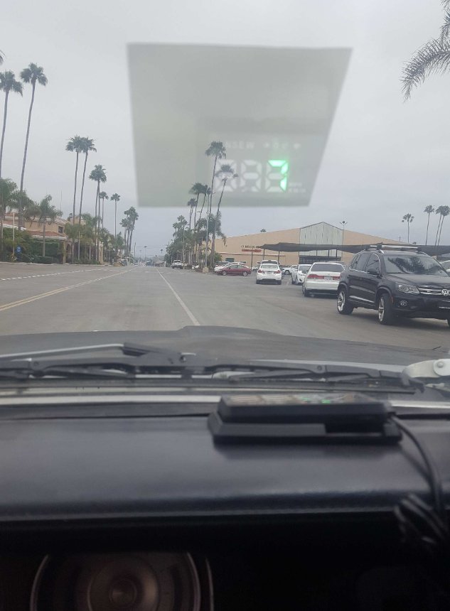

Ok so my crazy work schedule has slowed. Here are photos of the steering wheel installed. The HUD display and my voltmeter/ accessory modification.
That HUD is pretty cool. What can you tell me about it?
There were some questions on the HUD. I’ve tesed two from China/EBay so far. This one was crappy.
I found the above one wonky. It wants you to calibrate your time to a certain satellite and it wants you to calibrate your speed. It can be off twenty mph on The freeway. The buttons to adjust these are off. I couldn’t adjust it to get it calibrated. Avoid this one! It was a waste of money.
Much better below
The above one I’m still testing. It needs to be set from km/h to mph but with a little trial and error I got that set. It didn’t need any other calibration. The satellites readings are accurate. My only gripe is it came with a cigarette lighter charger and I’d rather hard wire it in. I’m probably just going to wire another cigarette lighter hidden behind the dash for it soon. It’s working good. Shows correct speed, shows compass and automatically adjusts brightness. To install it it’s basically put the sticker on your window and plug it into a cigarette lighter outlet, that’s it. I like to drive and just have it on while turning off my dashlights for long distances at night on the freeway. It’s quite useful as you can see your speed at all times without taking your eyes off the road, which you have to do to see your dash gauges for that brief second.
About $24 on EBay. Search “HUD display Gps”. And double check descriptions that what you are buying does not require OBDII as obviously that won’t work for a classic car.

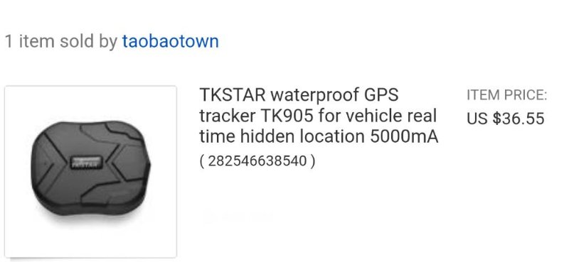

So more fun gadgets If my car ever gets stolen… I’ll find where it is and find you. This gadget is hidden inside my car. I can call a phone number and this little gadget tells me It’s location with a text with Google map link. :slight_smile:

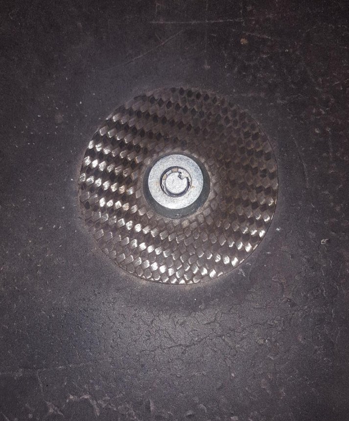

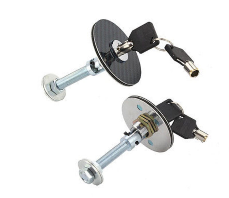

The previous owner had installed hood pins on the hood. He was worried about somebody messing with his engine so he had replaced one of the pins with a padlock. It looked horrible. I agree about the security aspect though so locking hood pins were put in instead.
Much better looking and nobody can just walk over and open your hood.

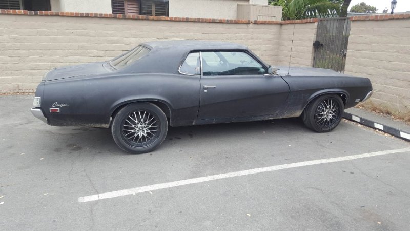

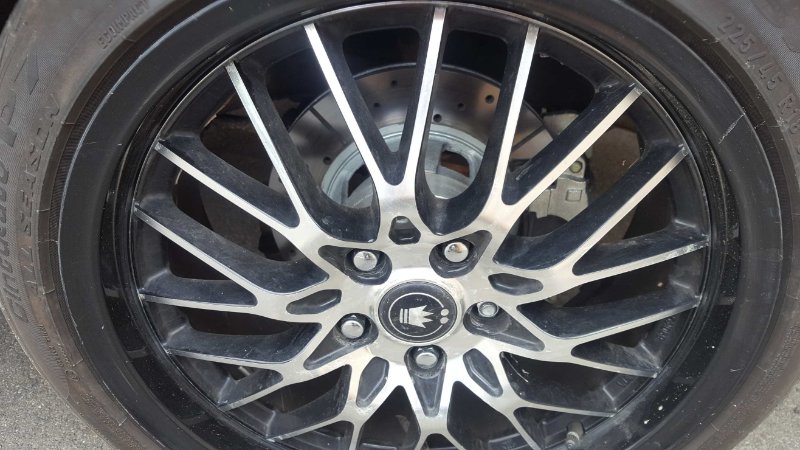

So two more photos. One how the car sits today and the other showing my front disc brake upgrade.
Some of the work so far done. Basically replace/renewed all the front suspension. The car had sloppy steering and most of the bushings were shot.
Upgraded to disc brakes. This fixed a few things at once and ended up costing me about $800 With installation using an eBay kit and getting help from a mobile brake mechanic off Craigslist.
