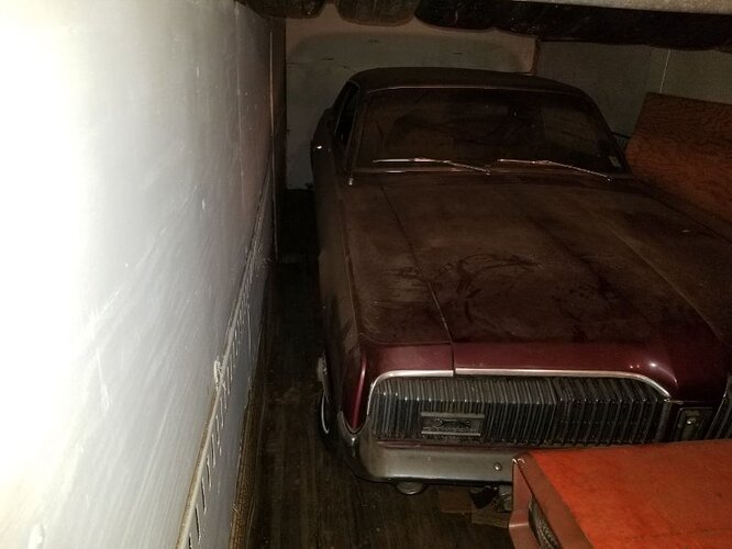

My father has given me his 67 Cougar GT to restore. He bought new in 67…
It had the 390 engine and transmission removed in the 70s because of leaded fuel issues…
The vehicle is all there to have numbers matching…

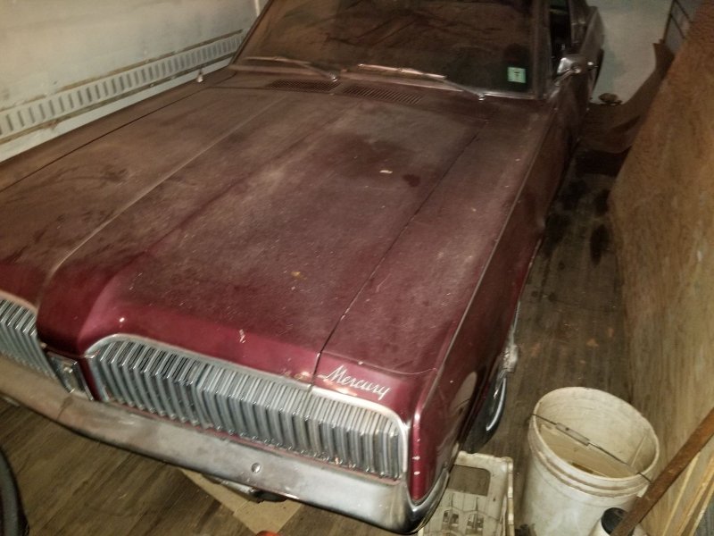

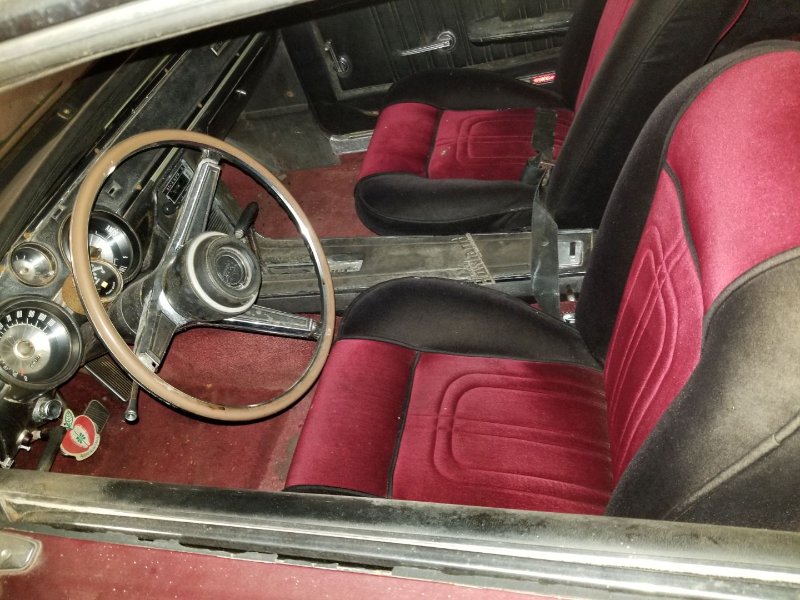

A matching numbers '67 GT can be a valuable car properly restored but it will still be south of $40K all done for 99.9% of the examples. To get north of $30K, you’d probably have to spend that and more. From your pictures, the interior has already been changed from original so it would have to be changed back to the correct upholstery and the rest of the interior would have to be refreshed significantly (or so it appears).
The 390 can be rebuilt for today’s fuel, as Phillip suggested above. That’s not a big deal. It’s the cosmetics and rust repair that drive most of the restoration cost. The more you want the car to be worth, the more expensive the cosmetics become.

I have the original engine, transmission and interior in storage. The current engine, trans, and interior is out of a maverick.

The body only very good with only a rust spot on the front of the engine bonnet.
The last paint was taken to metal but will need again and was quoted 8500 for that job. I figured 5000 for a good engine and trans rebuild. Probably put 15 into it to make it a driver… maybe I am not in the ballpark…
I am looking for a driver car but dont want to do anything to hurt any value.

Interior I think you can clean up and re-install yourself.
I would try and buff out the paint and see what you get. You might be surprised at the result.
