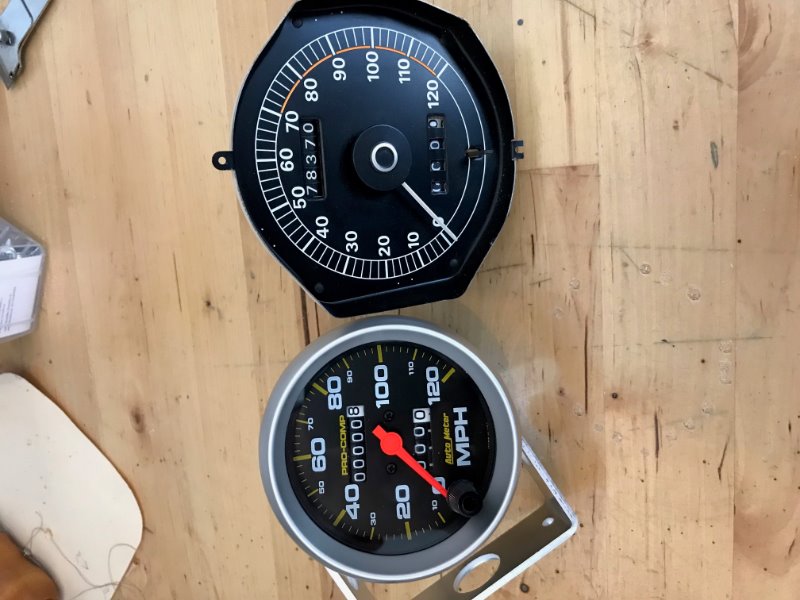

I got the new speedometer and adapter in the mail the other day and there are going to be some challenges.
  1. The Bezel holding the lens on the new speedo is crimped on and will have to be cut off.
  2. The Odometer area and trip meter area are closer to the center of the speedo and not more toward the outside edges like the original speedo.
  3. The trip reset on the new speedo is a twist reset instead of a push reset like on the original.
I found a program that will allow me to make a new gauge face decal, but I am still bouncing around ideas of how to get an identical face plate sticker to the original made. I will also have to form a new metal face plate so I can cut the two rectangular holes for the Odometer and trip odometer locations that match the locations on the new speedometer.
….and then there is the little needle swap and mounting the newly formed face plate to the new speedo and putting it all into the original cluster housing so the original lens can be used along with converting the centered push reset button to the eft offset twist reset knob… lots of fun in my future!
