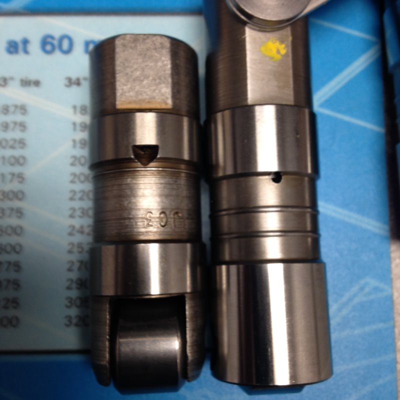

You can’t install factory roller lifters into a flat face block! You have to use lifters they supply in a kit. The O.D land and oil commutation holes are at a different location (height) due to the roller lifter being taller into the shorter bore designed for the flat face lifter. I have a side by side picture comparing the two, but can’t locate it. I pointed this out to Bob before in another thread sometime ago we had a discussion about it.
Here it is… stock roller lifter on the left and link bar lifter on the right which will be the same as a lifter they would supply in a kit. Notice the difference in the oil communication oil location and O.D land. Everything is lower on the lifter on the right to function correctly in a flat face block.
Better to find out now then the hard way… :wink:

Yes, but I think you will find once you start adding up all the cost for the specialty parts. The $800 drop in link bar lifters aren’t so expensive after all.
P.S. What’s a “flat face block”? A block that originally used flat face lifters vs. the later generation that uses roller lifters. The oil gallery location is at a different height relative to the camshaft base circle.
