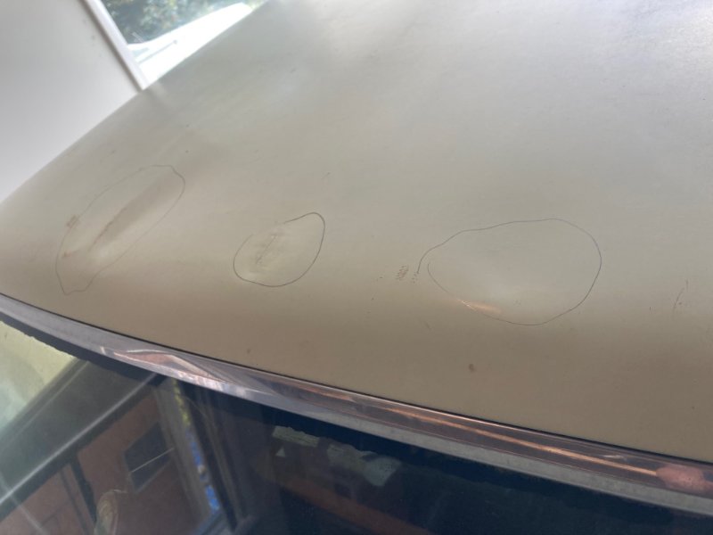

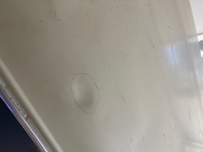

My '69 has several relatively shallow roof dents. I had a guy from from one of those dent removal places come by and quoted me $900-$1,100 to remove them. Originally the car came with a vinyl roof which had been cleanly removed earlier. I was going to go with not having the vinyl roof but after that I decided to install the roof (I got quoted $650 for it). I will need to take care of the dents even with the vinyl roof but it won’t have to look perfect at least as it would with paint. Has anybody done their own roof dent removal? Did you use a kit and which one? I know the sheet metal is twice as think as a new car but I think it can be done, thanks

I had very similar roof dents, but without creases, on my 68. I ended up using a stud welder system similar to that pictured. Used a constant pulling pressure on the welded stud (no slide hammer action) with light hammering along the edges to reverse out the dent (first in…last out). Once the dent was mostly out I used a hammer and dolly then minimal filler to finish. I also had access to the underside and removed the paint before starting. The welded studs are removed using a pair of pliers grabbing the stud at the base, as close to the sheet metal as possible, then twisting. The contact point will need light grinding to smooth out. Ended up being a lot of work, so it might be worth paying to have it done professionally.
