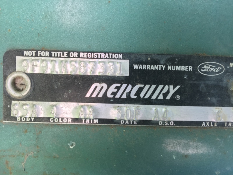

Could you post a picture of the door tag?
I think you will find that it’s hard to approximare value without knowing if there is rust in the undercarriage, frame, torque boxes, and floor boards.
It also really helps to see the door tag and know the original engine/transmission/color/trim.

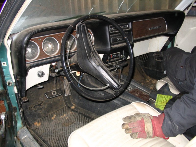

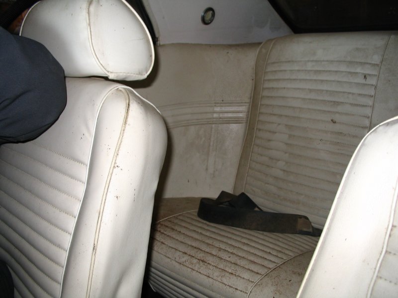

That interior looks like it might clean up okay.

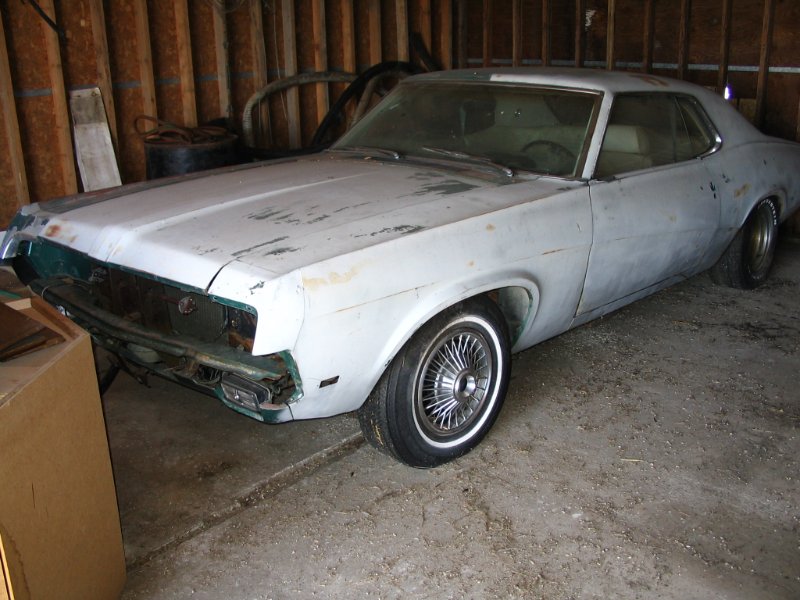

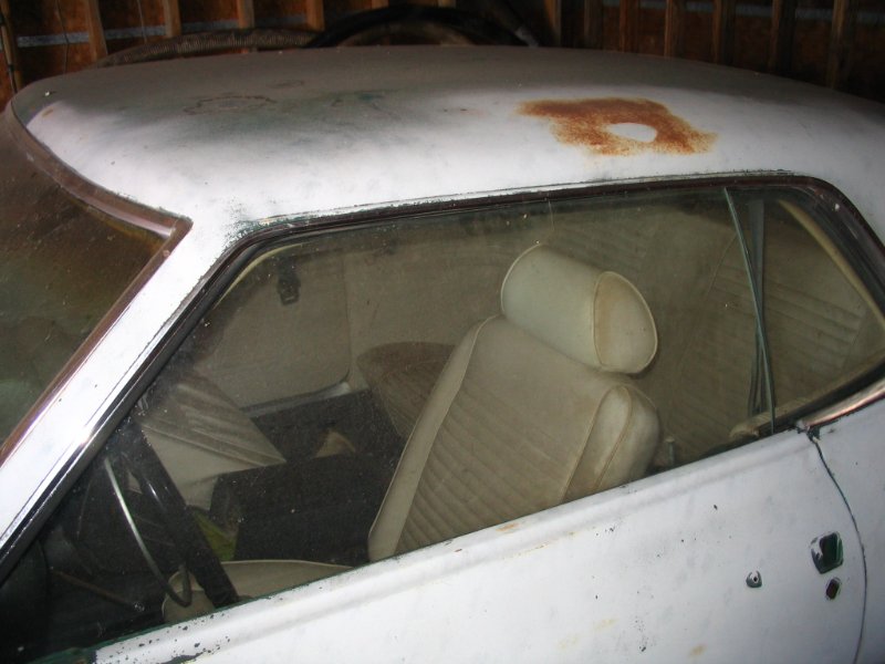

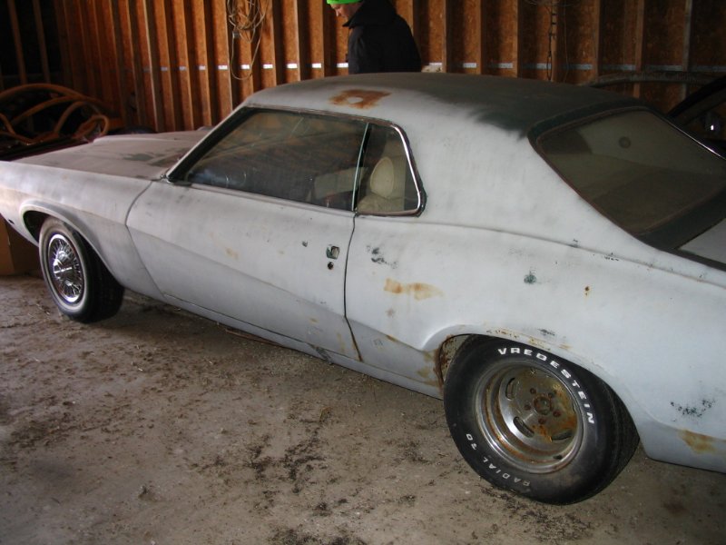

It also helps to know if the parts not on the car are with it and what condition they are in. A 69 Grill can be really expensive to replace it it is all missing for an example. Rust is a big deal, it is really hard to judge the extent of rust from your pictures. If there is not much that is a good thing. If it is extensive then the costs of repair goes up fast. Rebuilding the engine will depend on how much needs to be done. Expect it to need to be over bored and new pistons. heads should have hardened seats installed and most likely need new valves. I had a 351C rebuilt a few years ago, If I recall correctly it was about $5500 for overbore and rebuilding the heads as mentioned above. Your transmission may need to be rebuilt, I hear a lot of shops don’t work on the old FMX transmissions any more due to lack of parts. But I also understand that if all it needs is clutches and seals they are available. Expect that to cost $800 to $1000 or more.

I will try to get a picture of the VIN & door tag to post.

If it came originally with the 4v carb then it would have an “M” as the 5th digit in the VIN.
That would definitely add some to the value.
Hi Phillip,
Yes it is a 4v. Here is the door plate
Great, thanks for posting.
A factory 351 4v is a nice check in the plus column.
Medium Emerald Metallic paint with a White/Black interior.
Looks like a midwestern Canada DSO and 3.00 axle.
