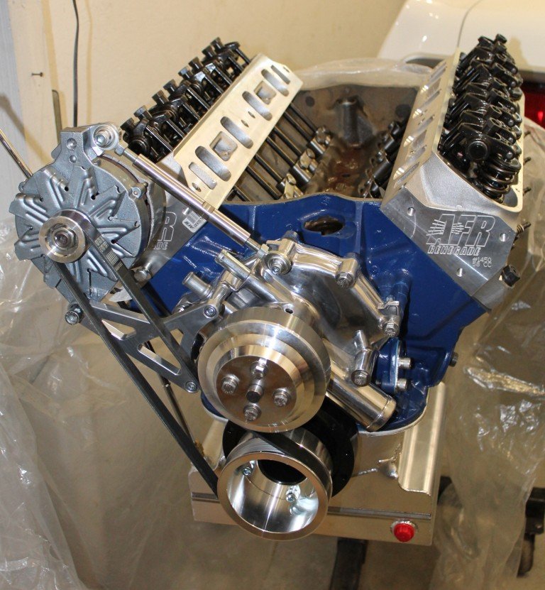

This is my 1969 351w and I converted it to 70 four bolt and bought the March kit. 302 reverse rotate pump so it’s on the driver side. I think their is a short/long pump option. Can’t remember what I bought for a balancer and would have to look it up. I had to change to a newer timing pointer. Since the photo I went to a bigger Alt pulley to slow it down as I hit 6,800 rpm on the track.
Cool thanks for all the info!!!
