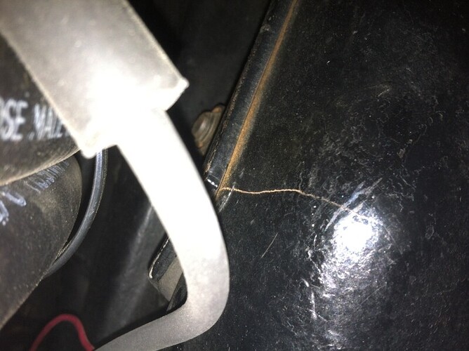

So the other day I took the cover off my 68 and opened the hood to just do a little detailing while enjoying a cigar in the garage. That is when I noticed this crack on my P/S shock tower that wasn’t there during most of 2015. It must have developed very late last year.

Always disconnect the battery before welding. Protect any glass that may come in contact with welding splatter or grinding debris.
Drill a 1/8" hole at both ends of the crack to keep it from propagating. Then, you’ll need to remove paint along the crack before welding. Best practices would be to cut a small “V” groove along the crack prior to welding. Make sure you have good penetration to the other side.
for repair all very good advise/must do, but if metal is fatigued tower should be replaced. Would a 68 mustang replacement shock tower fit?
Yes, The mustang is the same.
Replacing the tower(s) would be ideal but a task I’m not quite ready to take on. I know from this forum and the other that the 67-68’s suffered from this. I will proceed with welding first but being winter I’ll not know the result or success of the repair until the spring or summer after I’ve driven my car for awhile. I was hoping to hear from those that have done this repair and how it turned out over time. I appreciate the responses so far.

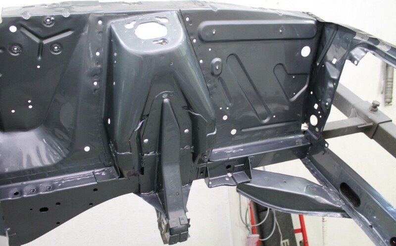

You might want to peel some of the paint off as a lot of times more cracks are revealed. If you just have one or two cracks welding it up as other advised will work just fine. You might want to consider adding a better Export brace to keep the top of the towers from moving. If you find multiple cracks you need to either replace the tower or add the repair kit. http://www.mustangsunlimited.com/itemdy01.asp?T1=PM6770+01&Category=Body&subCategory=Shock+Tower+%26+Related&SubSubCategory=Shock+Towers&CatKey=EMUSTANG
WCCC and other also have the bracket that welds in on top of the frame rail below the upper control arms that will really add some strength as well. Reinforcement Plates - Shock Tower - Weld In - PAIR - New ~ 1967 - 1970 Mercury Cougar / 1967 - 1970 Ford Mustang ( 1967 Mercury Cougar, 1968 Mercury Cougar, 1969 Mercury Cougar, 1970 Mercury Cougar, 1967 Ford Mustang, 1968 Ford Mustang, 1969 Ford Mustang, 1970 Ford Mustang ) at West Coast Classic Cougar :: The Definitive 1967 - 1973 Mercury Cougar Parts Source
I basically copied the repair kit and made my own for the road race Cougar. I didn’t have cracks in the towers, but just wanted to stiffen them up for the severe duty they were going to get.
