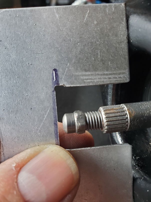

Background: I was working on setting the Push Rod Adjustment on my 70’s a rebuilt Bendix Brake Booster. Adjusted it from the initial setting (shown) then realized that the instructions call for the setting it with vacuum on the booster. Set up my Mityvac and tried pulling the booster down to 20". At about 7" it would pull down not further and some times just dropped to 5". Checked the Mityvac and tubing for leaks, it held at 20". Should the booster be bleeding vacuum?
I ended up setting it connected to the engine while running. It hardly moved from the setting without vacuum. Still concerned with the apparent leak.
