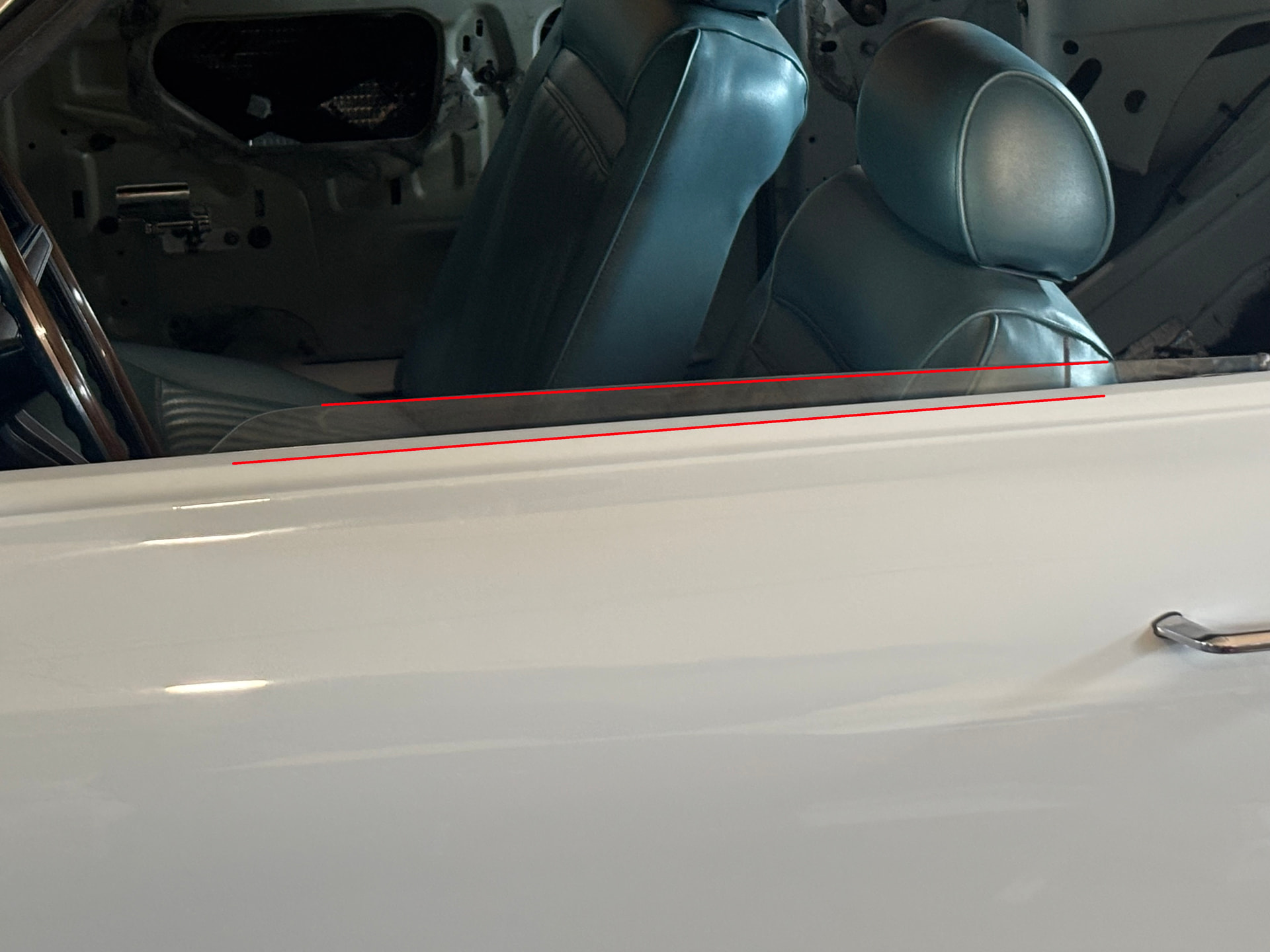

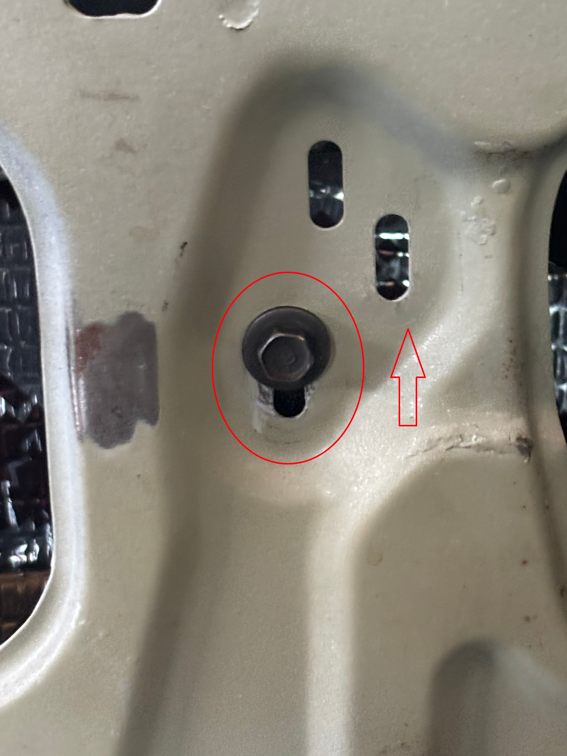

Having trouble adjusting the driver door glass on the ‘69 Vert. The passenger side seems to be fine. Trying to get the rear of the glass to tilt up more. It appears I am the limit of the adjustment slot on the door. Is there something I’m missing here?
I had that problem on the passenger side. My window was being held too high by the rubber bumper on the stop at the door bottom. Had to go with a smaller height rubber bumper that would let the window fully lower.
I could be wrong…but 69 and 70 doors used different height stoppers in the bottom of the door. With it being a 69 it probably has glue in windows and someone along the way has glued it back together not deep enough in the channel
It looks like the rear guide was re glued too far back on the window. I lengthened the adjustment slot in the door slightly allowing the front to drop more. That seems to have fixed it.
