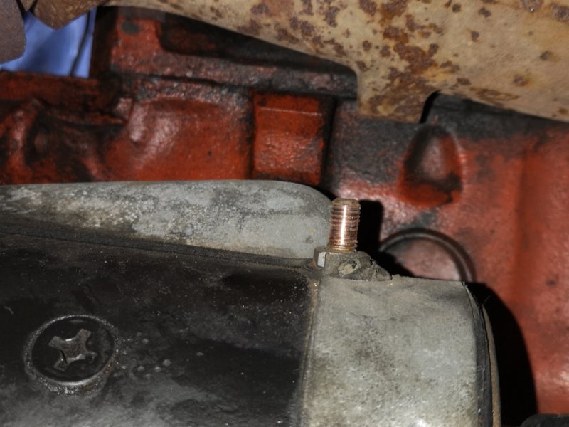

After checking everything again, I finally decided to pull the starter. That’s when I found the terminal post for the starter cable was stripped out. Apparently my starter cable connection was always loose.
I added a couple washers, tightened it back up, and all my troubles are gone. Guess I’m changing out the starter anyway, but not for the reason I thought.
