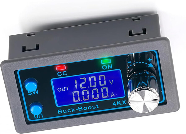

  2. Reduce the voltage to (just) the motor on the sequencer using a 12V buck/boost variable voltage converter module. This setup is less dependent on the input voltage variations. It is a better choice.

No, I do not sell this item. There are many versions on Amazon/Ebay that should work.
Some of these come with a digital built-in voltmeter and a potentiometer.
Most do not come inside an enclosure, but that can be 3D-printed or fabricated.
