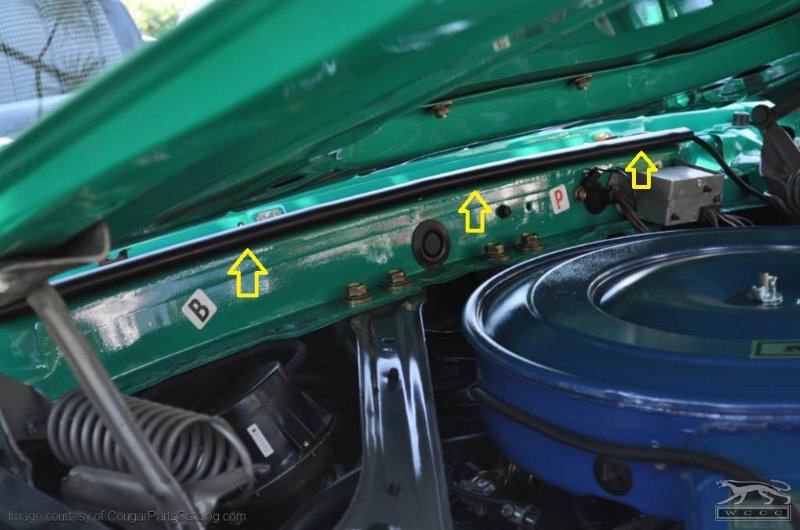

Check the rubber seal at the rear of the hood. Is it there? If so, is the hood adjusted so that the seal touches the hood and does its job? Either of these problems will result in the experience that you are having.

And as for the rubber seal at the rear of the hood. Do you mean on the firewall? I do have a gromit missing but the smell is overwhelming sometimes. People that have had rides in the car would say that they can smell gas.

Yes the seal is mounted to the top of the firewall. If the seal is missing or the hood is not adjusted properly you will have gas fumes going directly into the cowl vent regardless of what type of carburetor.
This part:

As for the runner gasket on the fire wall I’ll take a look

I really don’t know why it smells. But may be the comment about that rubber weather stripping under the hood could be my problem. The smell isn’t red gas smell it’s more like used gas smell. I don’t know if that makes sense but that’s the only way I can explain it
