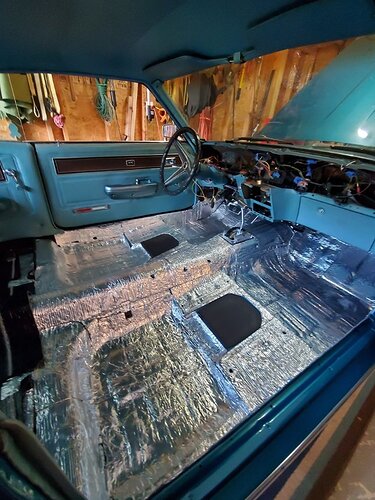

I used rolls of foil backed self adhesive Fatmat. It took the better part of 2 rolls to do the interior.

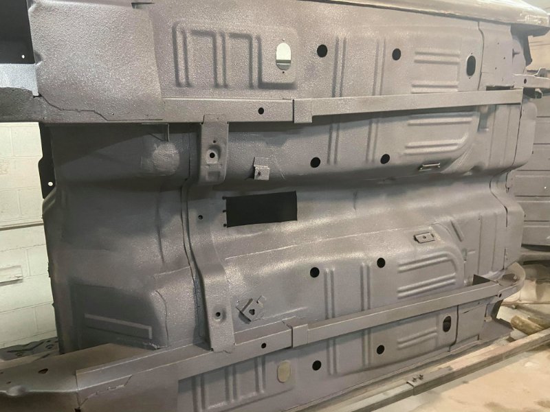

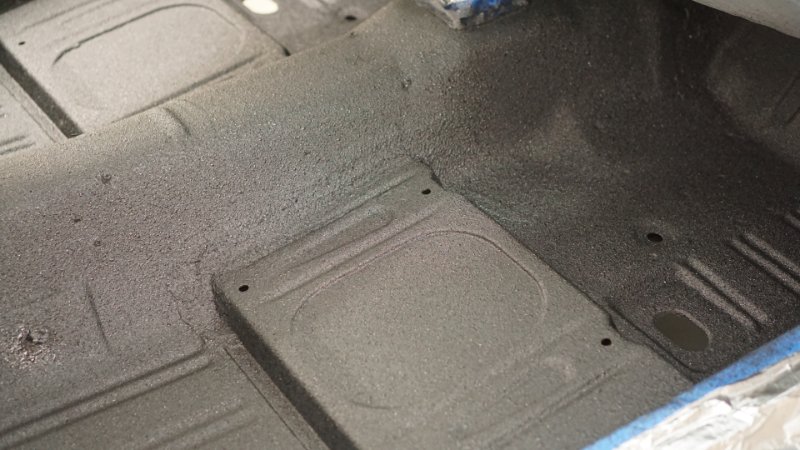

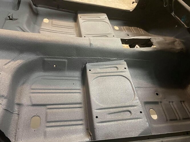

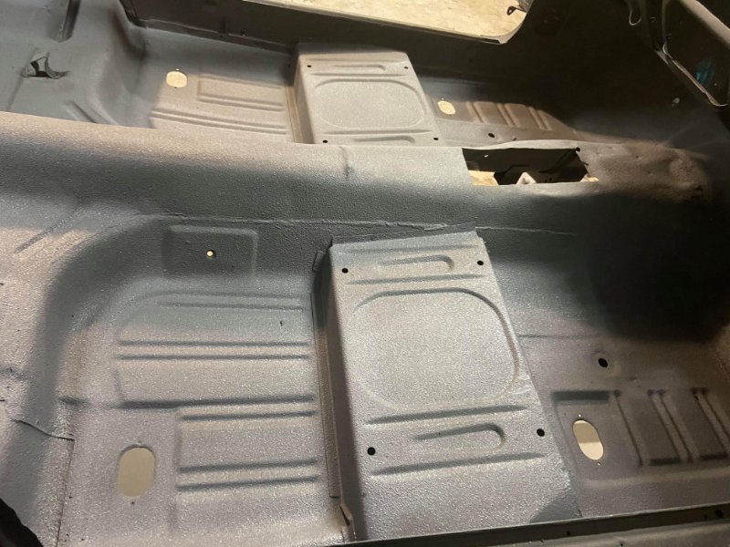

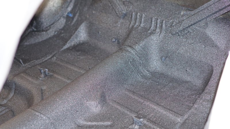

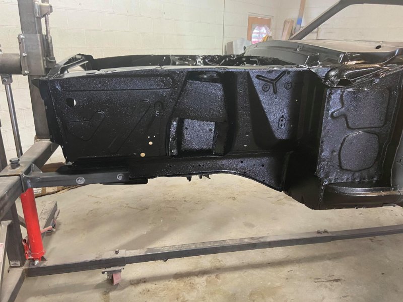

I might suggest you take a look at a spray on material. A painter friend of mine recommend UPOL Raptor coating. It’s worked great at sound reduction and weighs almost nothing compared to mat sheets. It doesn’t block heat so I used some foil up front. It’s a bigger undertaking with all the preparation work etc…
Thought I’d give a different perspective.
Is that like bed liner material?
Lizard Skin inside and out. Also helps seal against rust getting in the seams.
Yes but much much more. :wink:
