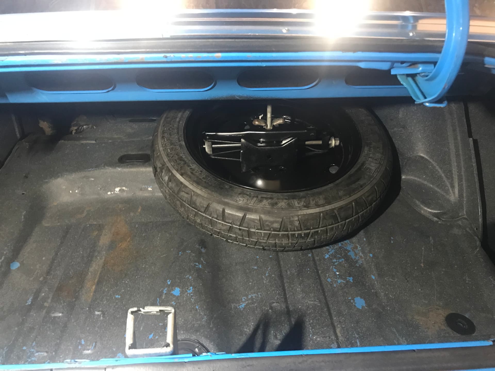

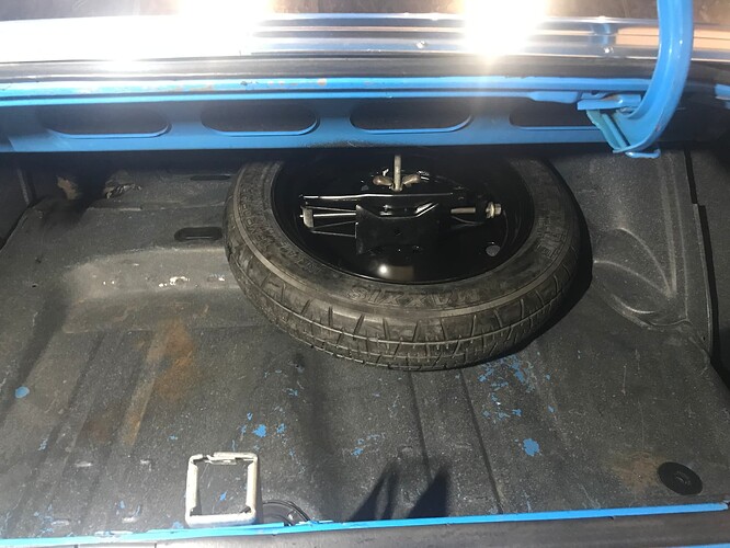

I got a 2007-14 FORD EDGE Wheel 17x4-1/2 Compact Spare Steel wheel on eBay and put a new tire on it. Works fine. Wouldn’t want to drive far on it. Better to put on a back wheel rather than steer with it on the front.
What is that, exactly?

Spare tire from modern mustang

I just gave away my original 14” spare rim with a relatively new tire on it to a buddy who is still running a stock set-up. In its place I had been carrying a 16” space saver spare from a jeep. It’s the same 4.5” bolt circle.
Now that won’t fit either since I upgraded to the Wilwood brakes. After some more research and FB marketplace shopping, I now carry an 18” space saver spare from a 2019 Nissan Rogue. It, too, is the same 4.5” bolt circle. But it’s more than that. It’s the same overall diameter of my rear tires so if I need to run it on the rear to limp home on, it won’t burn up my locker. While it’s very tall, it still fits on the front, even as lowered as it is. The offset is such that it is sucked in far enough that it clears both the inner and outer fenders at full lock in either direction,.so I can limp home on it as a front too… AND it clears the Wilwood brakes. $40 on FB marketplace.
