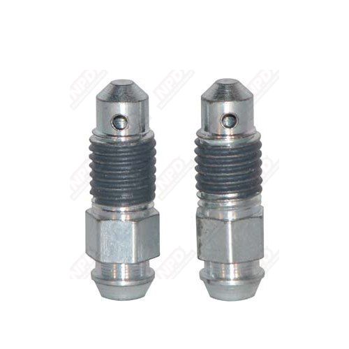

Anybody have any experience with speed bleeders? Do they work? Thanks.
I’ve used them with great success on my bikes including those with fairly sophisticated ABS systems. I’ve never tried them on a car but don’t see why they wouldn’t work.
They do work well. The only problem. The reman calipers have bleeder hole that are deeper due to the drilling the hole out deeper to get a good seal when rebuilt. The speed bleeders are then too short and cannot seat.
Thanks to you both. I’m going to try a pair on my front (drum) brakes.
