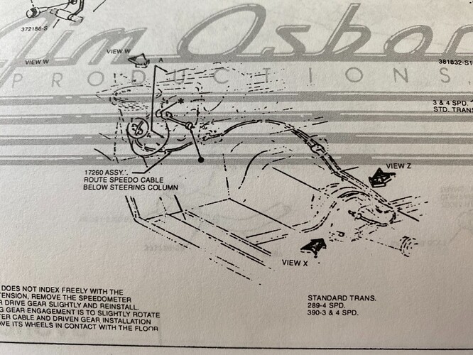

One thing I noticed looking at my chassis assembly manual: the big block 3 speed manual has the speedometer cable input on the passenger side, same as the 4 speed manual. You never said which engine you have but I thought this might be relevant.
