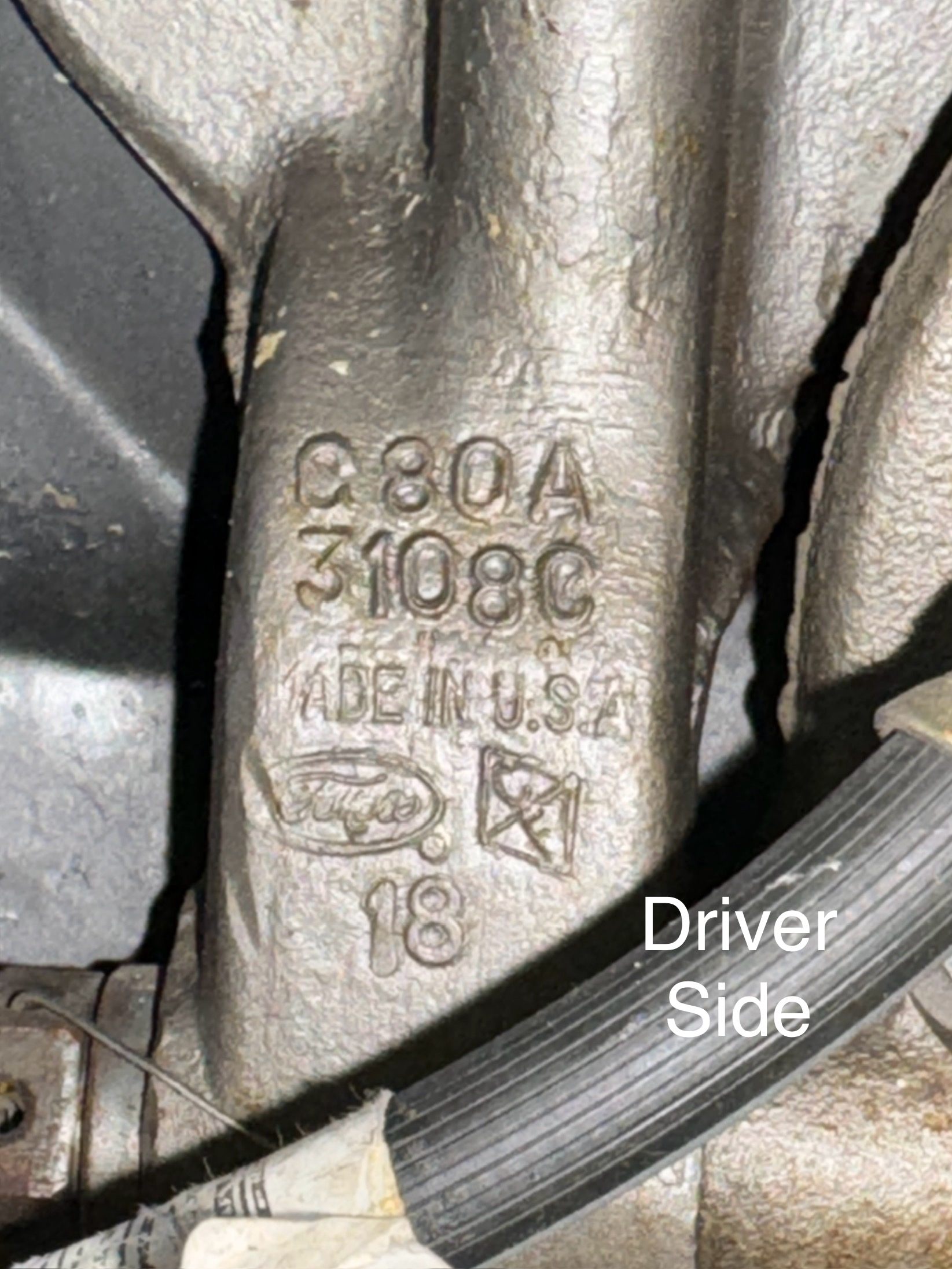

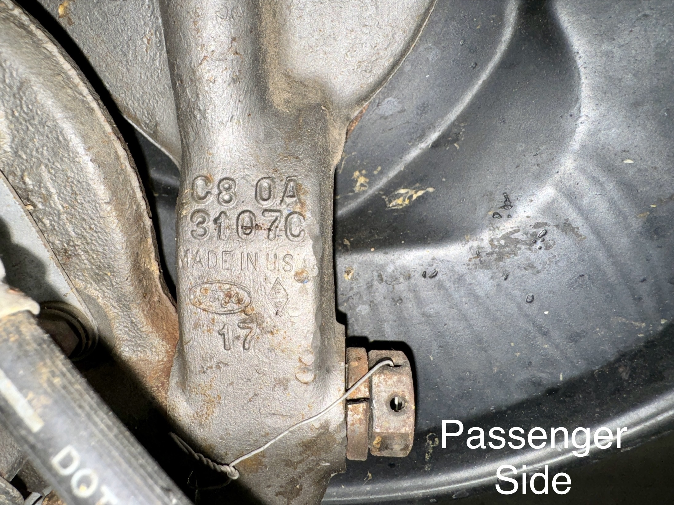

Not to Hijack SoCalPat’s nearly 10-year old post, but y’all seem to know a thing or two about spindles. Years ago, I had my front drums upgraded to disc, so obviously I needed different spindles. The guy who did it used C80A 3107C/C80A 3108C. Now, I’m replacing outer tie rods on my ‘70, but the studs on the new ones (Moog ES387R/L), which are supposed to be correct for 70 Cougar - don’t fit the hole in the spindle.
The existing tie rod studs are 0.565 at the base and 0.520 at the thread. The new Moogs are 0.0565/0.0605.
Do y’all think I bought the correct replacements for a ‘70, but the guy who did my front brakes rebuilt ‘em with 68 spindles?
Those are 1968 spindles. The 1970’s would be:
RHS ( Passenger ) casting # D0ZA-3107-C ( part # D0OZ-3105-B )
and the LHS ( Drivers ) would be casting # D0ZA-3108-C ( p/n: D0OZ-3106-B ).

Yep. That’s what I’ve found since. I phoned Moog and, just as suspected, ES387 has a bigger diameter ball stud. It would have been perfect for the ‘70 knuckles I thought I had…but for the ‘68s on my car. I need ES360. Problem solved. Thanks, gah
