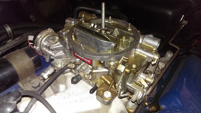

Thanks for all the suggestions guys. I finally got out in the oven that we call the garage tonight to poke around a bit. I didn’t see any obvious vacuum leaks but I did try the headlights, and the eyelids didn’t open on their own…this doesn’t really mean much though since the engine hasn’t run since Sunday.

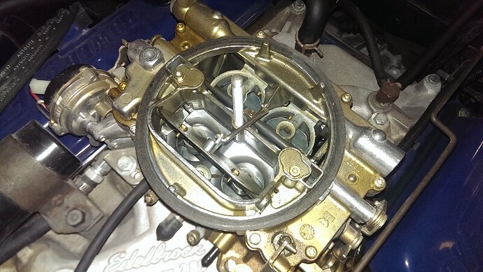

There does seem to be an overabundance of nastiness all around the outside of the carb that wasn’t there (that I remember) the last time I took the breather lid off. Not sure what to think about that. Looks pretty clean inside.
I’ll dig in deeper in the morning, but if any of you have any more ideas I’m listening!

It turned out to be all in the carburetor. I was thinking accelerator pump all along, but it was actually OK. The carb was just full of nastiness. The gas inside it had a foul odor and was brown and disgusting looking. I can’t say if it was because of the Sta-Bil 360 I have been using or just the fact that I don’t drive it enough…or maybe I just got a tankful of crap gas? At any rate, after a carb rebuild it is running better than it was when I thought it was running good! It’s easier to start when hot now, and zero hesitation at takeoff. LOL, in fact I left from a stoplight the other day and barked the tires TOTALLY BY ACCIDENT! I was looking around to be sure no officers were gonna need ‘splainin’ to!
