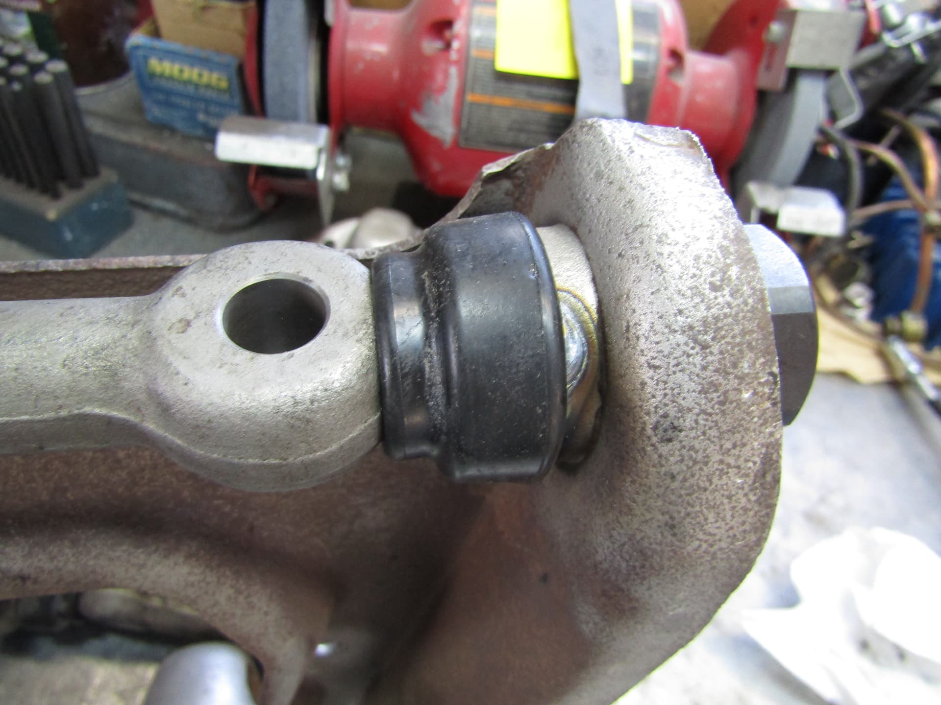

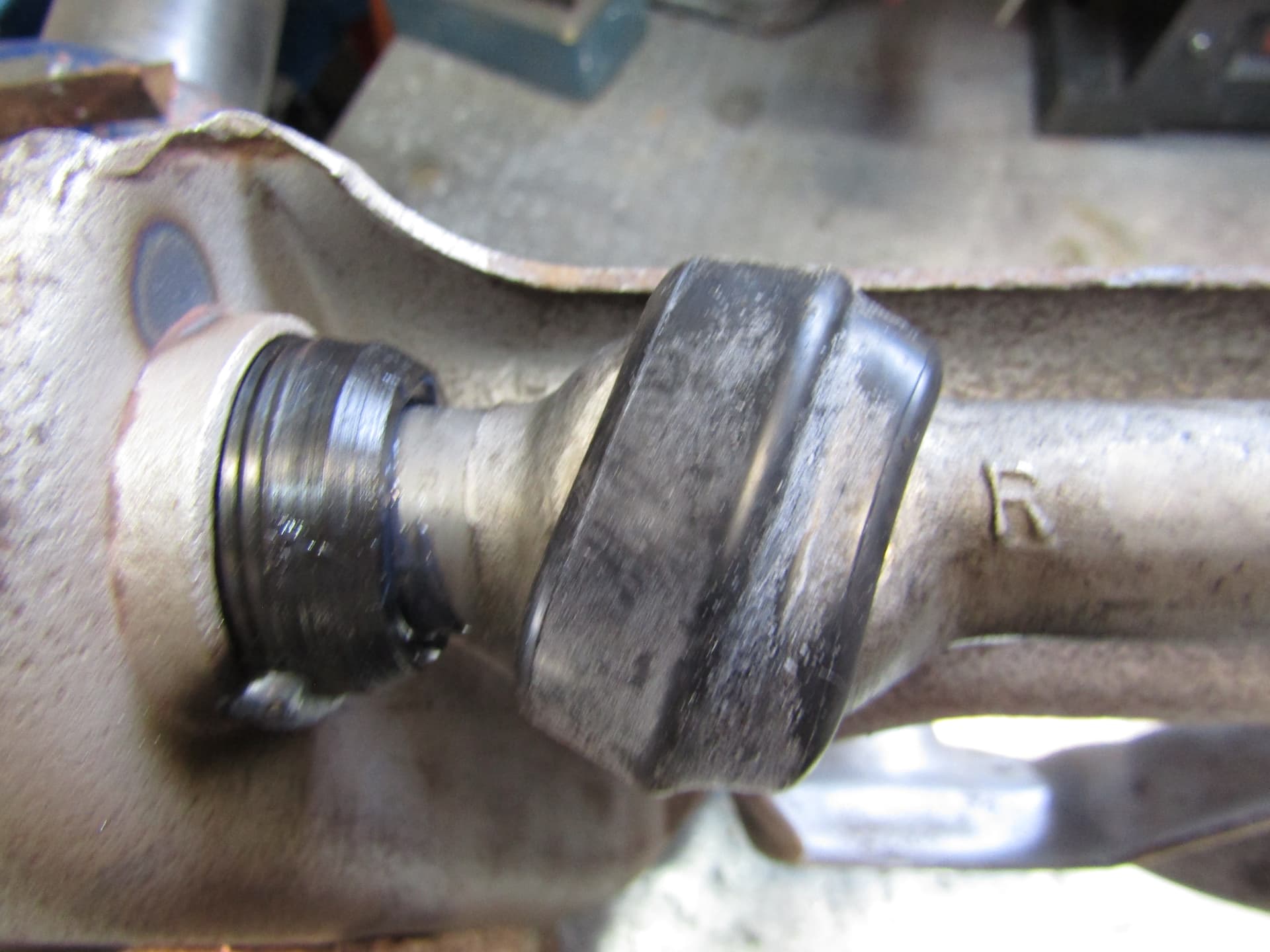

They are grease boots. I use silicone spray to get them on the shaft, weld, then slide them over the ends.
Other cheap shaft kits just use an o ring
