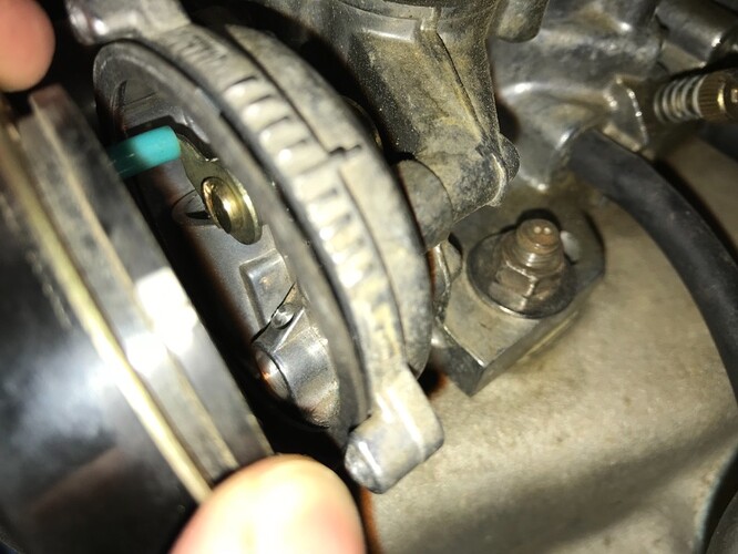

My car is a 1970 Mercury Cougar that originally had a 351 Cleveland with a 2 barrel carb. The carb was swapped to an Edelbrock 1406. The car runs good once you get going but has issues with starting and idling. It starts when you hold open the choke but for the most part just dies if you don’t keep it held open or pumping the throttle. Any ideas? I did take off the choke cover and I know the coil is heating up properly. I also noticed that the choke is missing a part that I can see in pictures of chokes. My dad said that you have to hold open the choke further than you should have to as well. I have attached an image with the part this choke doesn’t have. It doesn’t have the piece with the slot in it.

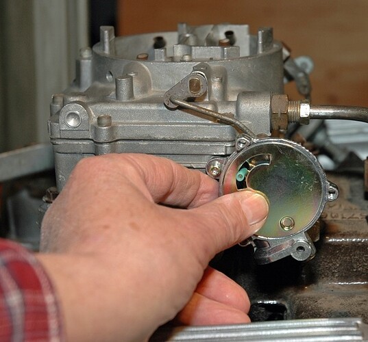

Can you post a pic of what yours looks like for comparison?

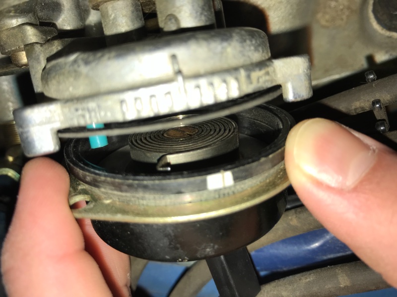

There’s some photos

If you are missing the baffle plate in the choke, you’ll likely need to replace that part to get the choke to adjust and operate correctly. Edelbrock has plenty of on line info on setup, choke adjustment and idle settings. I have a 1406 on my 351w and it is pretty simple to adjust.
Okay, I got a new baffle plate and am still having problems. The guy I bought it from said he had cleaned the carb. The car was just sitting in his shed. Just wondering what you guys would check first. I am not an experienced mechanic :frowning:
