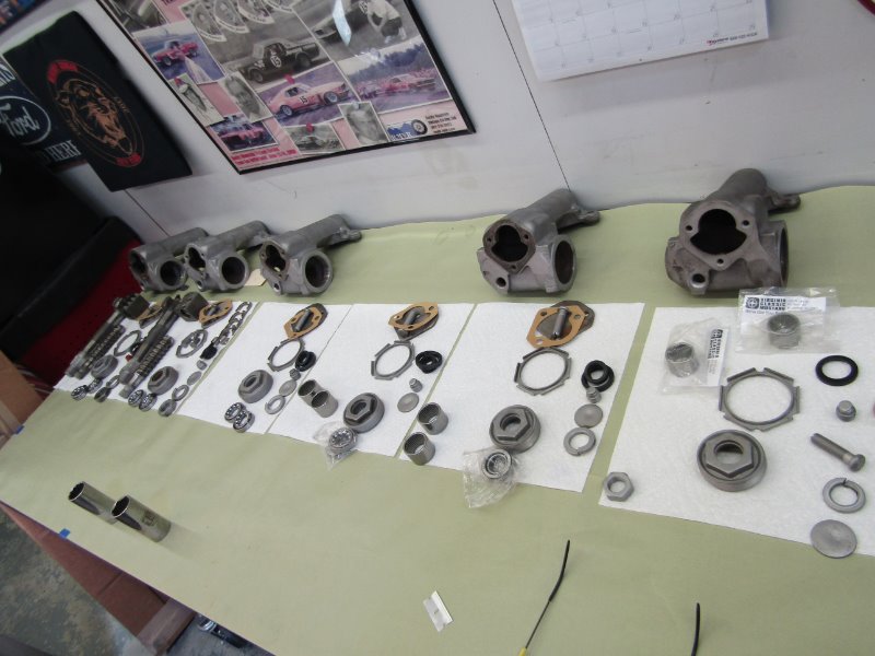

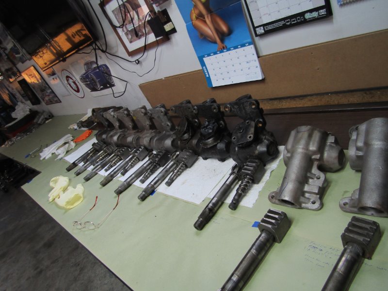

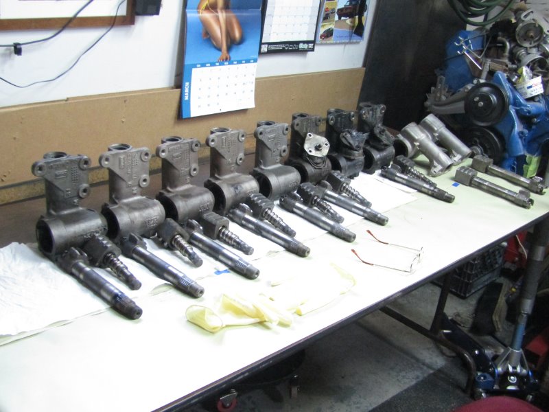

I recently rebuilt about 5 boxes using over 10 boxes. This was a pretty good rate of survival. I find the internal shafts suffer the most damage from water & old hard lube & grit. In the years of doing these boxes I have found many places/people who state they rebuild them. I’ve talked w/ at least 5 places advertised as doing a quality rebuild. After taking a few of them apart ( customers stating they bought the “rebuilt” unit only to have it go back to the loose state after only a few weeks.) the fact is clear. Using the old ball bearings is NOT a quality rebuilt unit!
What I found was the quality of the build was flawed almost from the start. Failing to replace worn or rusted parts is usually the issue. One rebuilder re-profiles the shafts, but uses the original 62 ball bearings. I’ve not found one rebuilder that replaces these with new ball bearings. Most likely due to cost. The ball bearings add almost $100 to the cost of the parts to properly rebuild a box.
I clean all parts & keep the 2 shafts from each box together as they have “machined” them selves to each other. Kinda like a cam & lifters. As you can see this is a long and involved task.
In short, many can clean & replace a few bearings & some grease, but few if any correctly rebuild them. An original box failure rate of over 50% is normal. So, before you start to throw $$ at a “rebuilt” box consider the above info…
I can rebuild yours, only if the internals are good. Suggest taking it apart & cleaning to inspect the internals.
Hope this helps everyone!
