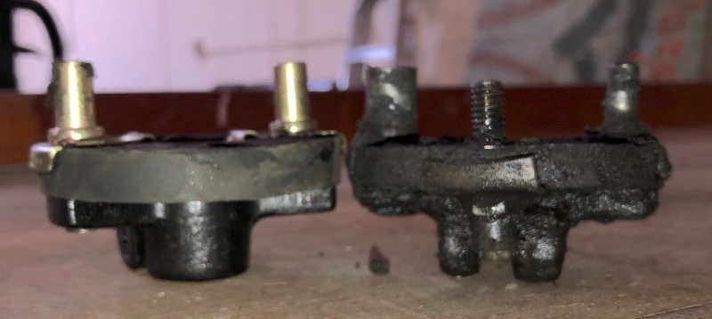

Good morning all, I wanted to share this in an attempt to give something back to the community. My car is a 1971 bass cougar without a tilt wheel.
The Lares 201 coupler will definitely not work with this set up because it is thicker or taller than the original. Hopefully this picture is clear, if you look at the difference in height it is significant enough that it won’t clear the working space.

Update - the Dorman 31000 kit has holes that are slightly off and it will need to be stretched a bit. The pins fit perfectly, but the fold over tabs do NOT fit from the original unit as the Dorman kit is has a larger outer diameter.
Dorman 31002 is too small for a 1971 without tilt wheel…

Lares 202 is too thick to fit, same issue as the 201. Both times he metal part and the rubber disk are shaped differently than OEM.
Looks like I’m going to have to use the Dorman 31000 and fabricate the metal tangs to fit properly.
