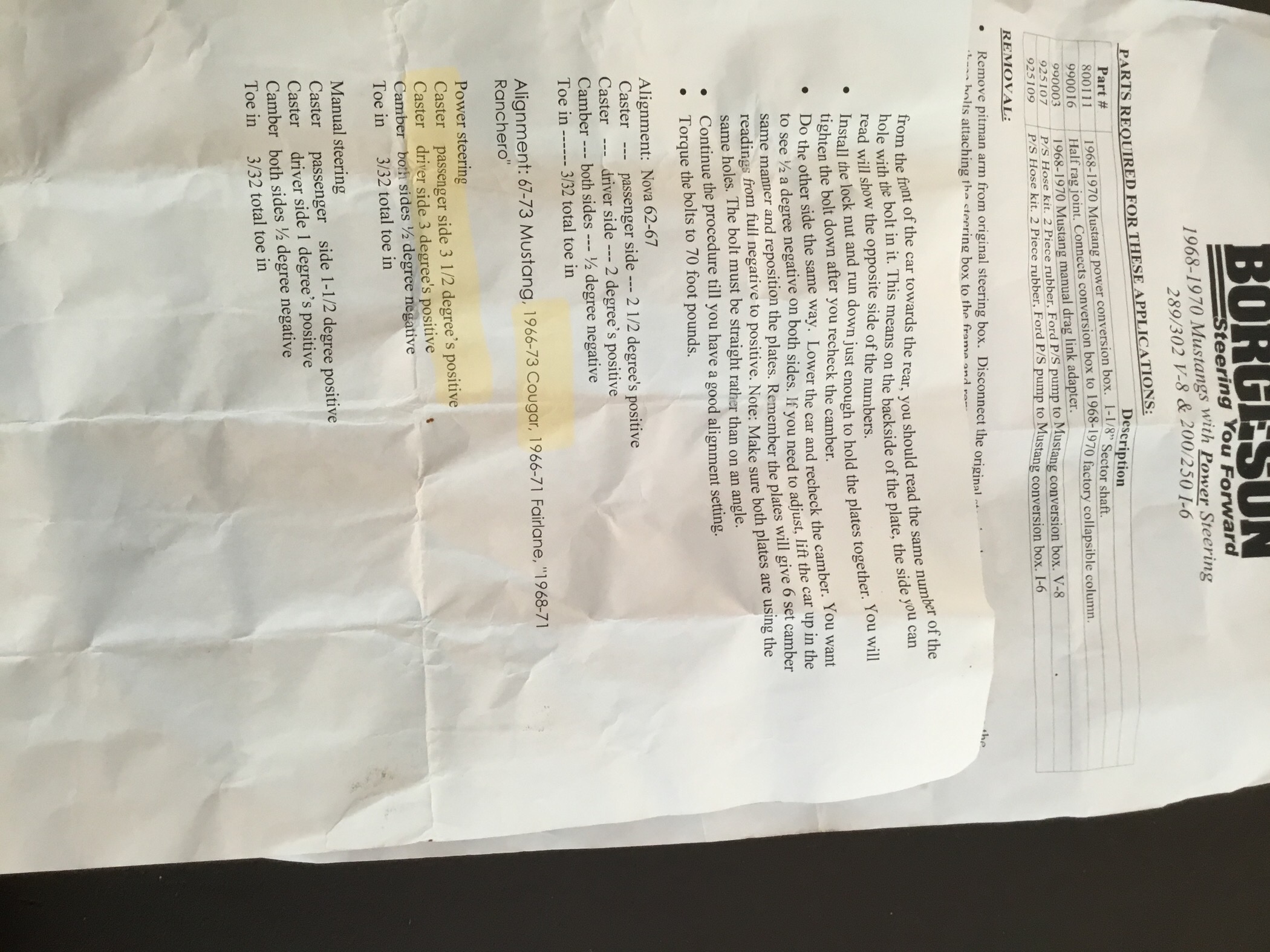

Hi,
It looks like your passenger side caster is off 0.5 degrees. I just installed a borgeson unit and their instructions provide 3.0 driver, 3.5 passenger.
I asked the alignment guy and he said it accounts for the crowning of roads for runoff. Without it the car will pull.
Hope that helps
I disagree on the caster. A bias will make a consistent pull in the same direction always (I use the same tactic because in Florida we have large crowns). Caster bias, however will not cause wander back and forth - that’s a classic toe out situation. Despite that, his toe looks good. I concur that alignment numbers (assuming the tech knew what he was doing) are the not the cause of the bi-directional wander.
