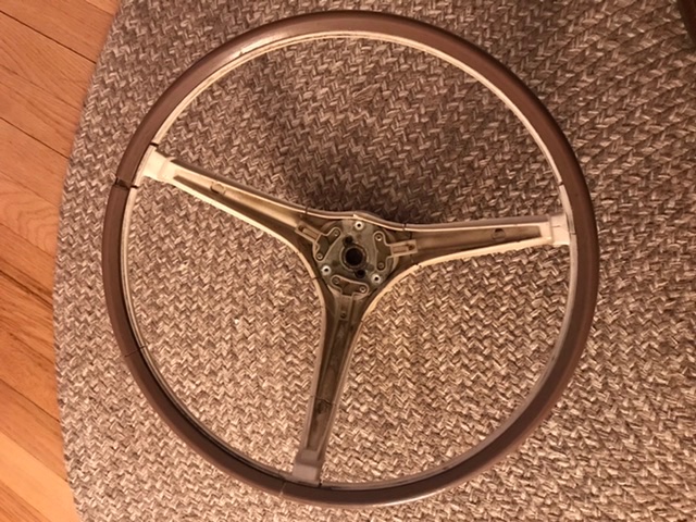

My 67 base steering wheel is in serious need for help.
See photos below.

Based on the photos do you think it is restorable?

Not only is it too far gone, none of the restorers want to deal with a 67 cougar wheel.

When I worked on fiberglass boats, we had clear fiberglass resin that we could color. We just added the color/tint to the clear, mixed in the hardener and brushed on the resin. If that’s still available, that’s the way I would go to try to restore your present wheel. Use a little modeling clay for a mold and fill the gaps with the white resin.
You might be able to make it better, but there would be some serious challenges. One of the ‘big ones’ is that the fingergrip bumps on the back side of that wheel are evenly spaced. Where it’s been pulled apart by cracks, there’s no way to space it correctly any more, even if you fill them in. If you dremel out some of the damaged spots to clean it up and give the surface more tooth for repairs to hang onto, you could use epoxy putty and then sand/grind everything smooth when it’s all dry. JB Weld makes some good products for this.

With enough patience and some bodywork skills, this wheel could be improved, but it will always look and feel a bit odd due to the spacing distortions created by the damage. Your cracks don’t look too wide, so maybe it wouldn’t be bad after all?

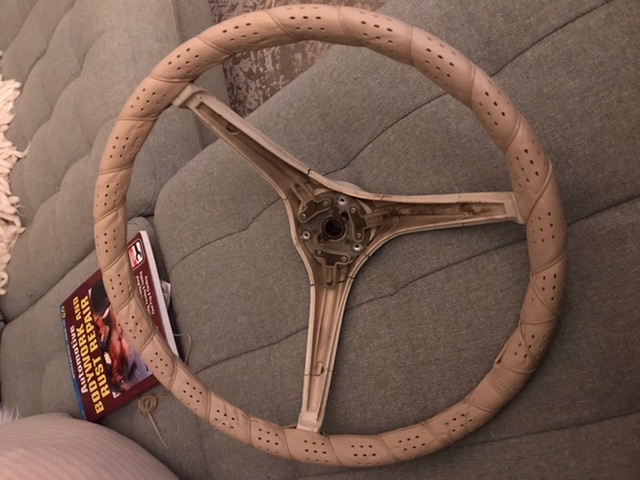

  1. Wrap my current steering wheel with something like sport grip just to hold the bit of the rim that’s coming off until my car gets to a properly drivable stage (many projects still going)

Here is the result of the first step ! I didn’t do a really good job I think I may have ordered a size too small but that will do !
At least I don’t have bits of the steering wheel hanging.
